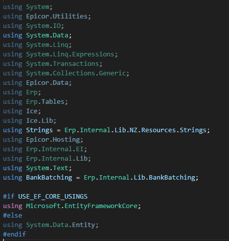

Payment_NZ_BNZ.cs(894,35): error CS0234: The type or namespace name ‘ManagementObjectCollection’ does not exist in the namespace ‘System.Management’ (are you missing an assembly reference?)
I do not know why it is complaining given that System.Management is referenced. I even tried to upgrade NuGet Package and changing versions for System.Management. It seems that Epicor do not allow using WMI with System.Management.
Help me with ideas on resolution.
You mention adding a reference to System.Management, but no mention to adding it to the usings section at top:
If you didn’t add it to usings, you would need to call it out by fully qualified name:
System.Management.ManagementObjectCollection collection;
vs.
If that doesn’t help (which it might not since it seems that it is already looking for it in the correct namespace) - maybe your assembly was referenced but didn’t load for some reason?
Thank you so much,
The reference and the using declaration are there. May be the assembly loading is not happening. I hope there is a way to explicitly force it to load.
