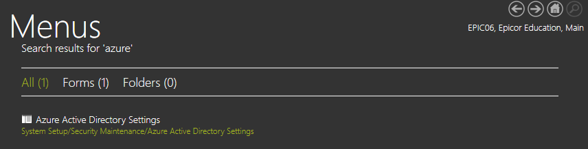

They don’t have any way of doing it in 10.2.500 as far as I am aware. Is that different for newer versions? I have blurry recollection of whether this changed in 10.2.600 or 10.2.700 or kinetic.
Would you please clarify what you mean by modern authentication methods and which of those are supported by Epicor?
If you do a Menu search and see this, then you have the capability. Somewhat sure that 12.2.500 had it.
