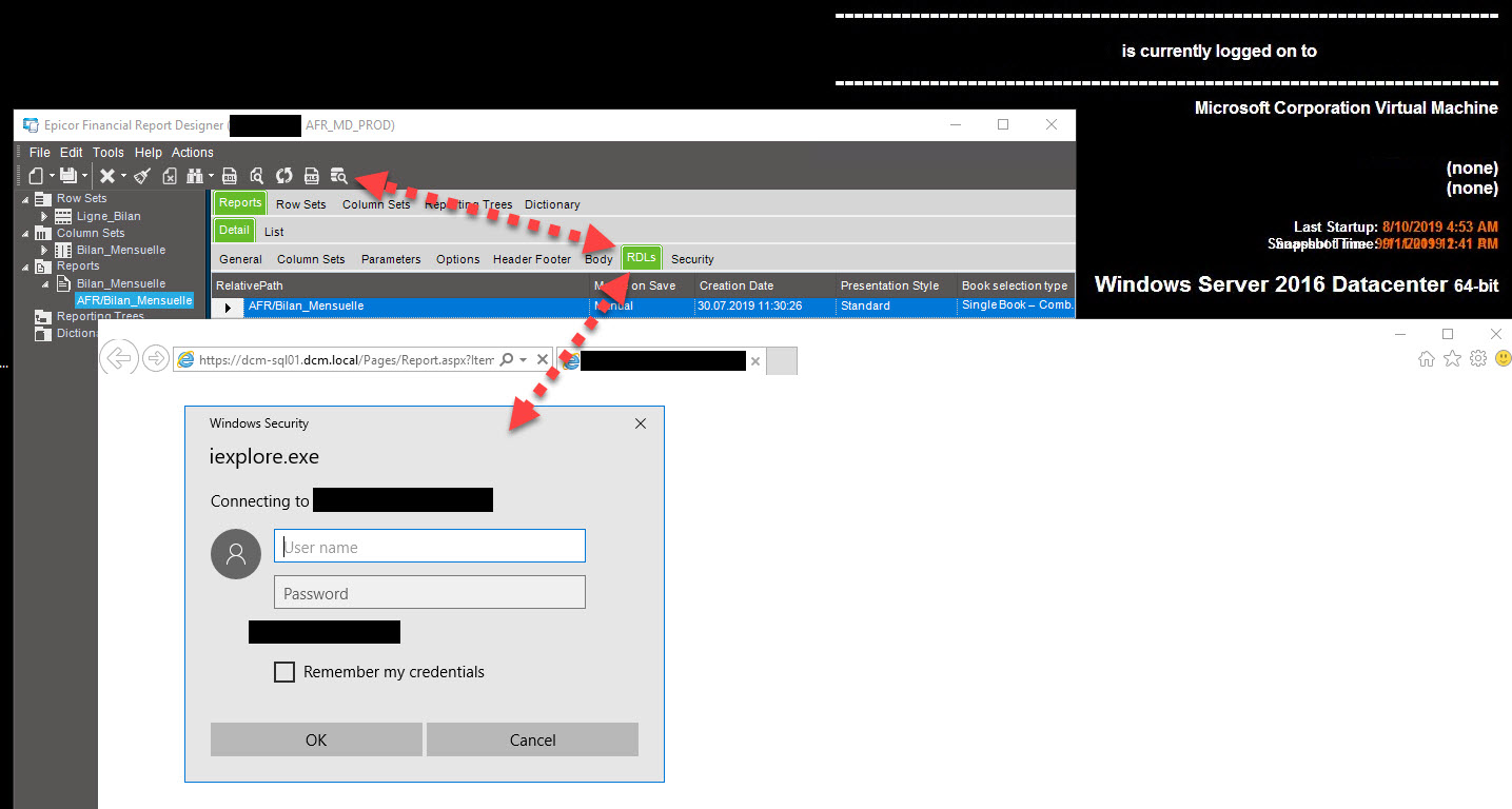

Anyone knows if it is feasible to avoid the login screen when previewing a RDL from the Report Designer Tool? We are on AFR 10.2.

I’ve tried the workaround of clicking “Remember Credentials” but it keeps asking for the login.

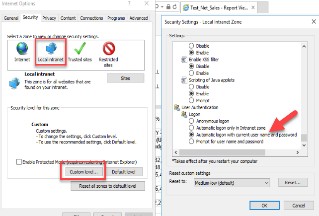

So I tested your question - When I log into the Report Designer (and use Windows Credentials) I get the prompt and IE will not ‘remember’ it for me either. I’ve tried a couple of different things, and found that it is IE Settings, Security, Local Zone. Set it automatically detect local zone:
And at the bottom of the list of settings (under Custom) choose the option to automatically login using current username/password.
This made it work inside Report Designer as you requested.
Wow. Very nice! Thank you very much.
