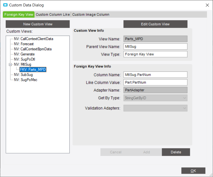

I created a customization in version 10.1.500.23 of the PO Suggestion entry to add a UD field from the Part table. I did a FKV linked to MtlSug on the Column MtlSug.PartNum. Worked like a charm.

I tried changing the FKV to link on the SugPoDtl but it didn’t help.

Can you show me your relationship between the fields on PO Suggestions and Part
I have already rebuilt the customization without it helping.
This is what I tried on the original one.

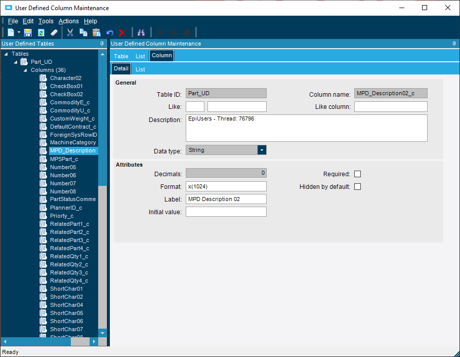

Hi Shawn,
I created the UD Field in the Part Table with the following:

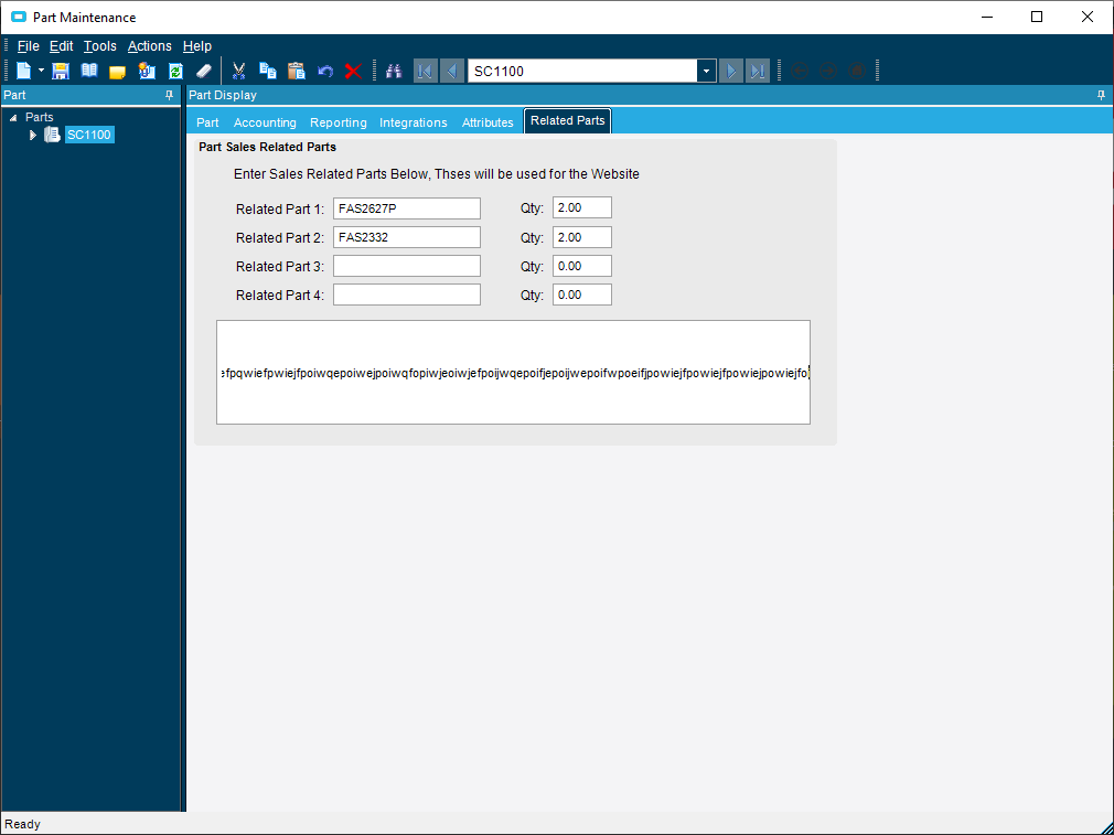

Updated the field with some information against a PartNum
I completed the setup and I’m not getting any errors… Have you tried a BAQDataView to complete this? Maybe a work around…
