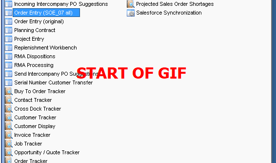

Also, on this customization of Order Entry, I get the âDownloading from DBâ message everytime it launches in a session - except when I have Memory Caching enabled. And I never have memory caching enabled, because it annoys me when I go to customize a form, and forgot to disable that first.
Hereâs a GIF of the form launching in the same session.

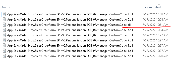

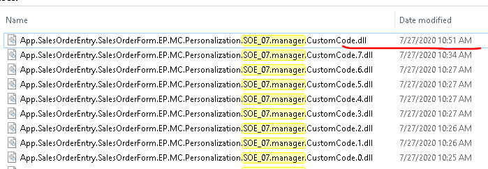

Calvin, youâre not crazy. Well, at least this isnât proof. Since 10.2.400, we saw this but I thought it was a SaaS thing. Not just at every login, but anytime you closed the form and went back into it.
If and when you go in in Customization / Developer mode it downloads a new .XX suffix and uses that.
If and when you go in as a regular user it uses the CustomCode.dll
This is my guess based on my observation of the behavior.
Clear out folder C:\ProgramData\Epicor\usdcaaps00371-808\3.2.300.0\MC\CustomDLLs
No files in folder
Launch E10
After client launches just one file (personalization of SysMonitorForm)
Launch Order Entry (customization SOE_07), not in developer mode
After SOE_07 loads, 2 new files App.SalesOrderEntry.SalesOrderForm.EP.MC.Customization.SOE_07.CustomCode.dll App.SalesOrderEntry.SalesOrderForm.EP.MC.Personalization.SOE_07.manager.CustomCode.dll
Launch SOE_07 again (still not in developer mode)
Two more files now appear in CustomDLLs folder App.SalesOrderEntry.SalesOrderForm.EP.MC.Customization.SOE_07.CustomCode.0.dll App.SalesOrderEntry.SalesOrderForm.EP.MC.Personalization.SOE_07.manager.CustomCode.0.dll
Note the added .0. to the file names
These two new files have the more recent file date
My test was entirely done in Test environment (but to be clear both Prod and Test use the same folders in c:\ProgramData\...)
Iâm not seeing it when i do it in my Prod environment. The custom DLL gets copied to the CustomDLLs folder, but doesnât add any ârevisionâ suffix.
