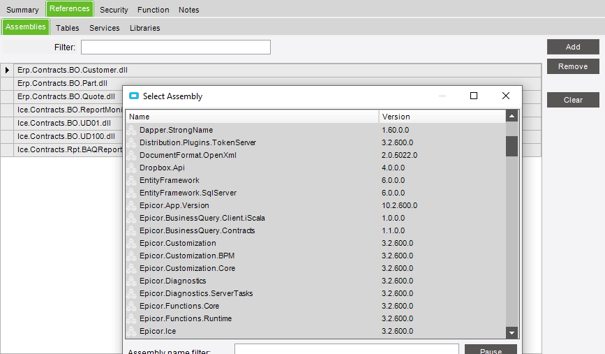

Is there a way to reference a custom assembly in an Epicor function? In my case I want to reference CSVHelper.dll that is located in my Customization/Externals folder.

In Functions Maintenance I don’t see a way to access the assemblies in the ‘Externals’ folder.
I’m guessing it’s by design (security, etc?), but was hoping I was missing something. If it’s OK for a BPM, why not a function?
Ah I see what you’re saying. It doesn’t even have the option to select from non-shipped assemblies

In your server configuration Aaron you can add a path to a folder Custom Directory and any DLL you put there will automatically be available server side. (That’s how we did it)
So does that meld the available contents of the default folder and the custom folder to be available in the Functions Assemblies area?
That makes those DLL’s available to the whole server so yes, BPMs, Functions etc. It can also be used to override Epicor’s own DLL’s if you are doing some fancy stuff with the SDK
So be careful dropping DLL’s with conflicting names in there.
Basically the server looks there first for the DLL and then in the regular Assemblies folder
In my case I was able to call a uBAQ from the function and use the necessary assembly in a custom method. Which was fine for what I needed that time, but would be messy at best and impossible at worst in other circumstances.

In the past I’ve copied my Externals folder right into the assemblies folder every time I build a new appserver from upgrade or whatever. It works but Jose’s way is “sanctioned” I’ll probably do that on the next rebuild.
Adding onto this, is there a way to get custom variable types for use in Functions from this?
I’ve got my dll showing in the ‘Assemblies’ tab, but none of the custom classes show up as a variable type to choose from.
