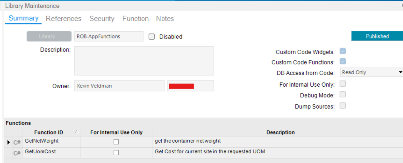

Is the function marked as internal?
You have an internal flag at library and function level. When selected it stops it from being run ‘externally’ which includes the API which app studio uses.
Makes it available to BPMs, other functions and schedules.
Neither the function nor the Library are marked as Internal only.
Additionally, all companies are authorized, my user is the owner, and it’s shared with EFx Power Developer.
