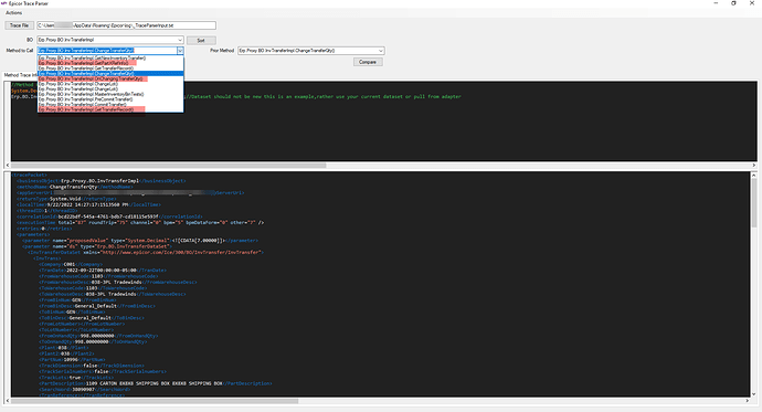

Here’s an example I’m working on with Inventory Transfer. The red ones I’m skipping.
+1 on what @hmwillett is saying.
Generally, the ones I don’t use are the calls to fill drop-down boxes or other UI-related purposes. An API won’t need those.
