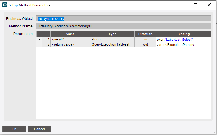

I read some posts about invoking a BAQ in an Epicor Function, but I can’t seem to figure out how to set a value from that BAQ to a variable that I create.

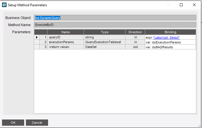

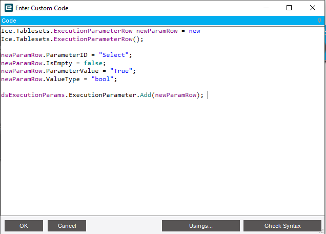

There is a ud_Select_c field on the JobOper table. I want to bring in only the JobNum, AssemblySeq, and OprSeq when the Select_c is checked, in order to perform additional processing in my function. I was able to invoke the BAQ in my function but am having trouble retrieving any data from the <return value> dataset.

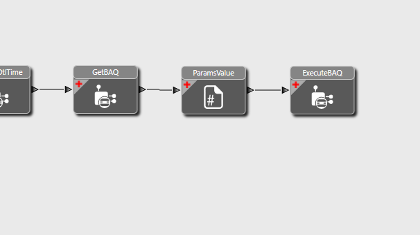

Here’s what I got so far:
How do I retrieve data from the return dataset? For example, when I try to assign the JobNum from the BAQ to another variable, I get nothing from the dsBAQResults table. Does anyone know what might be the issue? I suspect I might be missing something important.

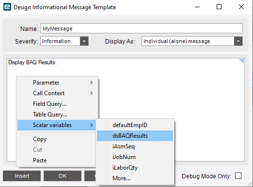

Let’s say I want to display only the JobNum in a message box from the dsBAQResults table. How do I do that? Alternatively, how can I assign the value from JobNum to another variable outside of dsBAQResults.Tables?

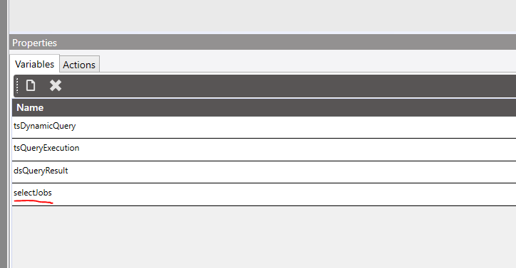

if you want to display the first JobNum in a message, you can set a BPM level variable (like your “selectJobs”), you would then do something like this
// String variable DisplayJobInfo set in the BPM Variables
DataRow FirstRow = dsBAQResults.Tables["Results"].Rows[0];
string dispJobNum = (string)FirstRow["JobOper_JobNum"];
int dispAsmSeq = (int)FirstRow["JobOper_AssemblySeq"];
int dispJobOpr = (int)FirstRow["JobOper_OperSeq"];
DisplayJobInfo = $"JobNum: {dispJobNum}\nAssembly: {dispAsmSeq}\nOperSeq: {dispJobOpr}";
Then in your message, you can just add the DisplayJobInfo variable, which will be formatted like this:
JobNum: 12345
Assembly: 0
OperSeq: 10

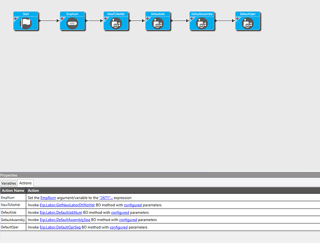

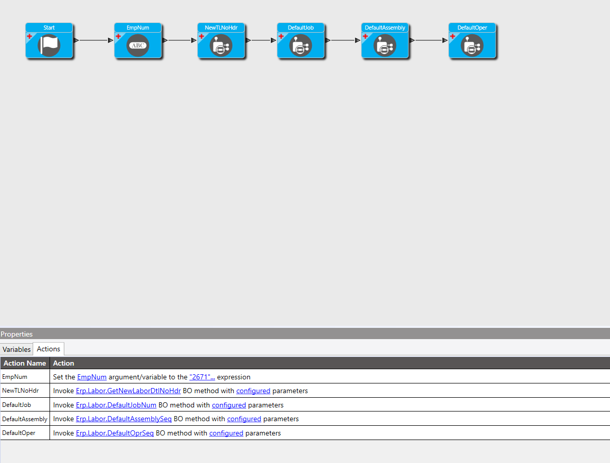

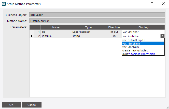

I created a separate function and defined EmpNum, JobNum, AssemblySeq, OperSeq, and some other variables as input parameters. However, to invoke the Erp.Labor.DefaultJobNum and Erp.Labor.DefaultOprSeq, I will need to know the JobNum and OprSeq, which are coming from the BAQ. Otherwise, I will receive an error: ‘A valid Job Number/Job Operation Sequence is required’ on the REST API.
Would it be possible to get the results from the BAQ first and then define my variables to tie to the JobNum, AssemblySeq, and OperSeq for BO method calls? Or is there a better way to do this? I want this function to automatically create new labor transactions on Time Entry when users select a Job/Assembly/Operation.
I apologize, as I am learning as I go, and I really appreciate your time helping me out.
Yes that’s exactly what we’ll be doing. So when you create your new function, you can set Input parameters. You will only call that function from inside the loop, and you’ll pass the Job, Assemply, and Operation in from the original Function
