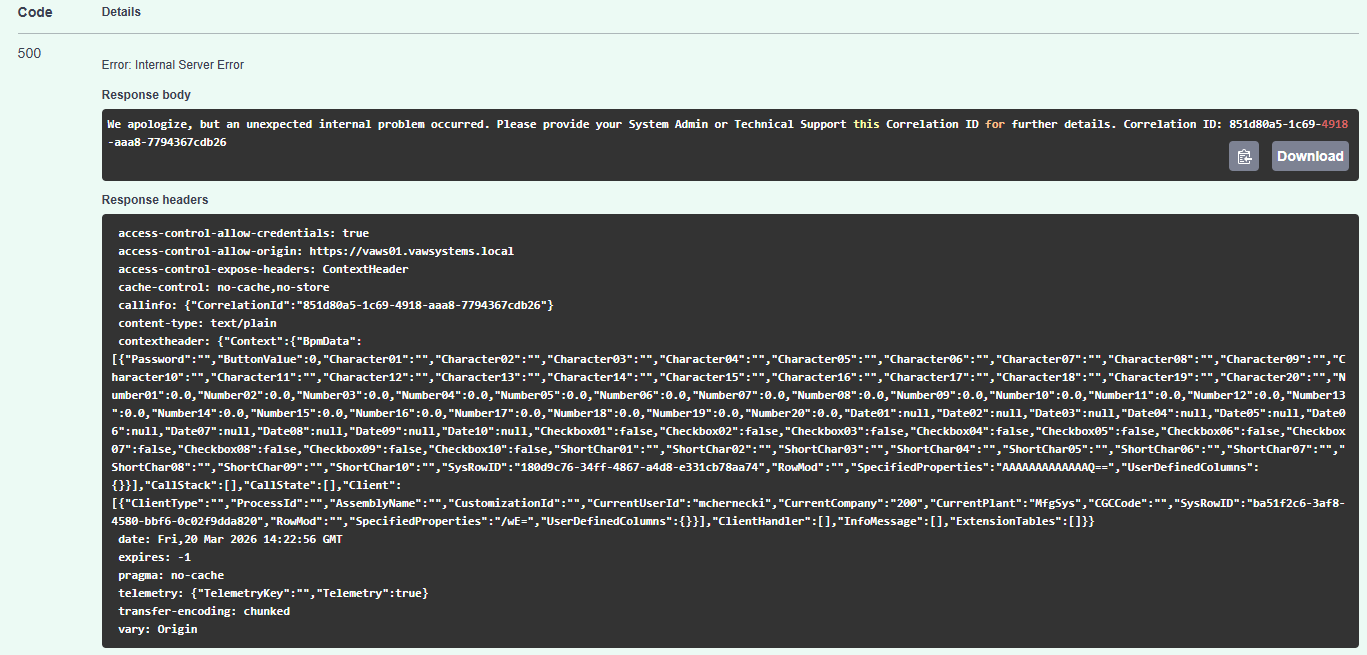

I am working on upgrading to Kinetic 2025.2 and trying to move a customization on the Sales Order Classic UX to a server function. I was making some progress, but ran into some issues. Currently, my issue is I get the following error when calling SalesOrder MasterUpdate.
  "HttpStatus": 404,
  "ReasonPhrase": "REST API Exception",
  "ErrorMessage": "Record for update was not found by its SysRowID value [00000000-0000-0000-0000-000000000000].",
  "ErrorType": "Ice.Common.RecordNotFoundException",
  "ErrorDetails": [
      "Message": "Record for update was not found by its SysRowID value [00000000-0000-0000-0000-000000000000].",
      "Type": "Error",
      "Program": "Epicor.Ice.dll",
      "Method": "UpdateRow",
      "LineNumber": 1052,
      "ColumnNumber": 21
  "CorrelationId": "9b8f551b-697c-4c95-9868-a581d6f947f6"

Am I doing something wrong or missing something?
RowMod=’U’ is for existing records with real SysRowID. If you add something, you need RowMod=A
Suggest doing a trace of the process to see how Epicor does it checking the data but my money is on @Olga said
I have come this far by doing a trace and adding the same methods. I did use RowMod = “A” initially, but when I do that I get an internal server error.
Generally you can’t update a header and a dtl row at the same time. You create the header first, update, then add the dtl rows. The header shouldn’t have a row mod at all at that time. So having an “A” on header and detail is probably what your problem is.
The sales order will always be existing, no need to create it. I only added the header update last when trying to resolve this. The 500 error still persists after removing all reference to the header row.
Can you post your updated code then?

I got past the server error; there was a type mismatch while setting a UD field in another part of the code not shown above. However, even though it does run, prices and quantities are not being updated. I am adding the suggestion to reset the OrderDtl variable.
My code is running without error, but the price is not being updated. Here is my updated code with UD fields added.

Ok, I am losing my mind trying to find out what has gone wrong. The code was working on Friday, new sales line added, quantity and pricing updated correctly. Today I demote the library and make a copy of the working function before moving on. Now neither the original or the copy work. There are no errors, but no new sales line is created. Did I accidently change something? Does anyone notice anything in my code that looks wrong?
    CallService<Erp.Contracts.SalesOrderSvcContract>(so =>
        // Load exisitng order
        var soDS = so.GetByID(orderNum);
        //Add a new order line
        so.GetNewOrderDtl(ref soDS, orderNum);
        //Populate the new line
        var dtlRow = soDS.OrderDtl.First(r => r.RowMod == "A");
        dtlRow.PartNum = partNum;
        dtlRow.RowMod = "A";
        //ChangePartNumMaster out/ref parameters
        string replacingPart = partNum;
        bool substitutePartExist = false;
        bool isPhantom = false;
        string uomCode = ""; // returned by the method
        string deleteComponentMsg = "";
        string questionString = "";
        string warningMessage = "";
        bool multipleMatch = false;
        bool promptToExplodeBOM = false;
        string partMessage = "";
        string subPartMessage = "";
        string explodeBOMerrMessage = "";
        string msgType = "";
        bool multiSubsAvail = false;
        bool runOutQtyAvail = false;
        string cMsgTypeSaleable = "";
        so.ChangePartNumMaster(
            ref replacingPart,
            ref substitutePartExist,
            ref isPhantom,
            ref uomCode,
            Guid.Empty,
            false,
            false,
            false,
            true,
            true,
            true,
            true,
            out deleteComponentMsg,
            out questionString,
            out warningMessage,
            out multipleMatch,
            out promptToExplodeBOM,
            out partMessage,
            out subPartMessage,
            out explodeBOMerrMessage,
            out msgType,
            out multiSubsAvail,
            out runOutQtyAvail,
            out cMsgTypeSaleable,
            ref soDS
        //Reset OrderDtlTableet
        dtlRow = soDS.OrderDtl.First(r => r.Added());
        //dtlRow.LineDesc = partDesc;
        dtlRow.OrderQty = partOrderQuantity;
        dtlRow.SellingQuantity = partOrderQuantity;
        dtlRow.UnitPrice = partUnitPrice;
        dtlRow.SalesUM = GetPartUM(partNum);
        //dtlRow.PricePerCode = "E";
        //dtlRow.ProdCode = GetPartProductGroup(partNum);
        //dtlRow.SalesUM = GetPartUM(partNum);
        //dtlRow.SellingQuantity = partOrderQuantity;
        //dtlRow.SalesUM = "";
        //ChangeSellingQtyMaster out/ref parameters
        decimal ipSellingQuantity = partOrderQuantity;
        bool chkSellQty = false;
        bool negInvTest = false;
        bool chgSellQty = true;
        bool chgDiscPer = true;
        bool suppressUserPrompts = false;
        bool lKeepUnitPrice = true;
        string pcPartNum = partNum;
        string pcWhseCode = "";
        string pcBinNum = "";
        string pcLotNum = "";
        int pcAttributeSetID = 0;
        string pcDimCode = GetPartUM(partNum);
        decimal pdDimConvFactor = 1;
        string pcMessage = "";
        string pcNeqQtyAction = "";
        string opWarningMsg = "";
        string cSellingQuantityChangedMsgText = "";
        so.ChangeSellingQtyMaster(
            ref soDS,
            ipSellingQuantity,
            chkSellQty,
            negInvTest,
            chgSellQty,
            chgDiscPer,
            suppressUserPrompts,
            lKeepUnitPrice,
            pcPartNum,
            pcWhseCode,
            pcBinNum,
            pcLotNum,
            pcAttributeSetID,
            pcDimCode,
            pdDimConvFactor,
            out pcMessage,
            out pcNeqQtyAction,
            out opWarningMsg,
            out cSellingQuantityChangedMsgText
        dtlRow.SetUDField<decimal>("Weight_c", partUnitNetWeight);
        dtlRow.SetUDField<string>("WeightUOM_c", partWeightUnits);
        dtlRow.SetUDField<decimal>("Length_c", partUnitLength);
        dtlRow.SetUDField<decimal>("Width_c", partUnitWidth);
        dtlRow.SetUDField<decimal>("Heigth_c", partUnitHeight);
        dtlRow.SetUDField<string>("DimensionUOM_c", partLWHUnits);
        dtlRow.DspUnitPrice = partUnitPrice;
        dtlRow.DocDspUnitPrice = partUnitPrice;
        dtlRow.DocUnitPrice = partUnitPrice;
        dtlRow.SetUDField<int>("QuoteQty_c", quoteQuantity);
        dtlRow.SetUDField<decimal>("LabourHours_c", quoteLabourHours);
        dtlRow.SetUDField<decimal>("LabourCosts_c", quoteLabourCosts);
        dtlRow.SetUDField<decimal>("MaterialCosts_c", quoteMaterialCosts);
        so.ChangeUnitPrice(ref soDS);
        //MasterUpdate out/ref parameters
        bool lCheckForOrderChangedMsg = true;
        bool lcheckForResponse = true;
        string cTableName = "OrderDtl";
