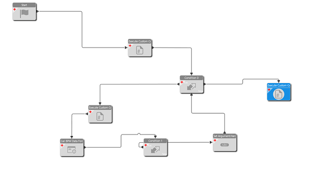

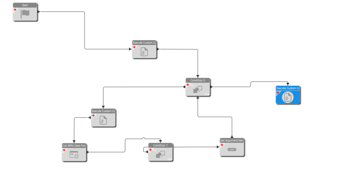

At this point I’m boiling it down to the simplest and most readable custom code block I can.
At this point, I’m boiling it down to the simplest and most readable custom code block widgets I can.
Without calling yet another query, I can’t figure out how to add more than 1 row to a query
inside with widgets.
I could use row_number to generate some, but need a way to limit the number of rows
getting pretty complicated
At this point, I’m boiling it down to the simplest and most readable custom code block widgets I can..
Here is what I did, I put the execution parameter additions in their own custom code block.
Simple as I could make it.
my variable was qeTS (QueryExecutionTableset)

So you can create a variable and increment it at the end then loop back to the beginning using that variable as an array index and a condition widget where indexvar<2
Effectively looping with the widgets it’s awful and ugly but it does work
I was trying that, but how do you add another row to the execution parameters.
That’s where I’m lost.
You call GetNew on it on the BO there is a GetNewExecutionParameter call (or something similar)
Ok, but now add it to the execution Parameter table…
And you can only use widgets.
When you call GetNewExecutionParameter you pass on execution table set and the new row is automatically added to that table.
I’m on my phone so I can quite test it but it should work
