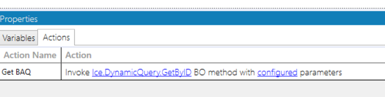

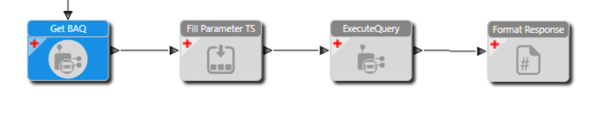

Sure. I added some logic to version the query, so I’ve left that off. But this is the basic:

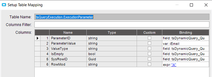

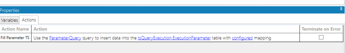

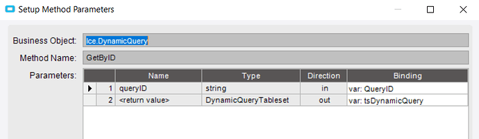

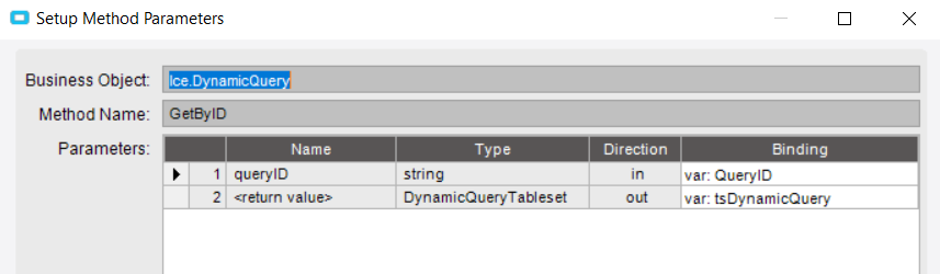

1.) Execute Invoke BO

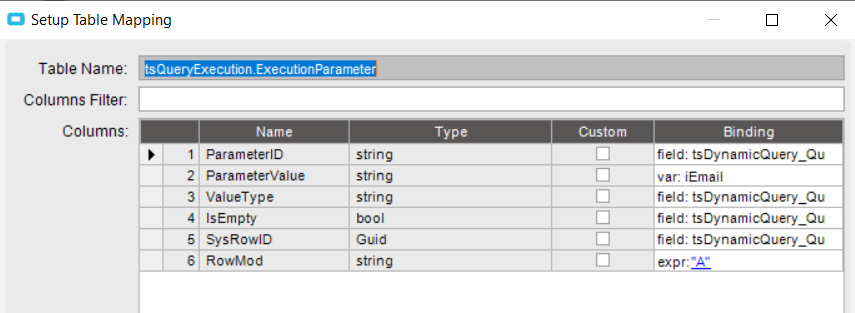

2.) Fill in the Parameters using Fill Table by Query. (This is a single parameter BAQ in this case but you just have to make sure that you’ve filled out all mandatory parameters).

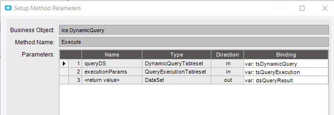

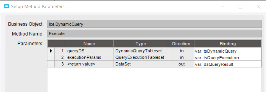

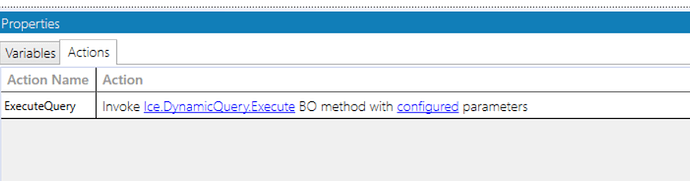

3.) Execute the query using the Invoke BO again
4.) Convert result to json and return using Custom Code. Remember to add your reference for Newtonsoft if you use it!

Oh, make sure to use the RowMod “A” when filling the parameter table.

Sorry to bring back this old thread. First time playing with functions and trying to wrap my head around step 2 (Fill Parameters). Are you able to show what your ParameterQuery query looks like? Also, my BAQ has 2 parameters and not sure how that is handled (does the Binding values need to be comma separated?). Thank you very much!

I strongly recommend messing around with the Business Logic Tester tool. It’s great at visualizing the objects returned by various methods.
Or the Swagger/OpenAPI pages if you move over to REST.

Yes with the widgets. I think I figured out the ParameterQuery query as my function now works, but using a 1 parameter BAQ. It is when using BAQs with multiple parameters that I still scratch my head :laughing:

Sorry for the late response @maxtin, Like @hmwillett, @josecgomez has me working instead of replying to messages on EpiUsers.
Basically, I would do expressions for the Bindings using nested tertiary operators to make a case statement using the parameter name to update the QueryCtrlValues:
(dsBAQQueryCtrlValuesRow.ID == "Parm1") ? "Parm Value 1" :
(dsBAQQueryCtrlValuesRow.ID == "Parm2") ? "Parm Value 2" : ""
Haven’t tested this, but hopefully you get the idea how to do that with either the Fill Table by Query or the Update Table by Query widgets.
