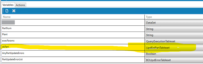

Probably… but I created the Variable for it and doesn’t this line initialize it?
Erp.Tablesets.PartPlantRow newRow = new Erp.Tablesets.PartPlantRow();
(Pretend I have no idea what I’m doing, I’m at that, just know enough to get into trouble)
no, you just init’d the var called newRow, not dsPart.
dsPart = new UpdExtPartTableset();
So setting up the variable on the Variables tab doesn’t initialize it?
no it just defines the holder (reference)
