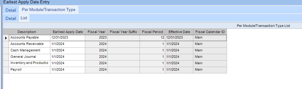

Welcome to the forum! Looks like your script is trying to use a date in the past (Nov 2023) and your fiscal period is closed in that month. Which makes sense. Maybe adjust the script to use today’s date or something in the current month.

Fiscal Period screenshot:

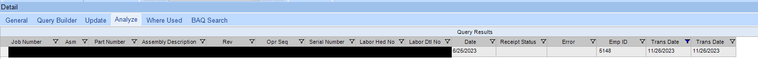

Can you run the BAQ in the designer? What are the values (results) for Date20? Assuming you’ll see at least one dated 11/26/2023? We don’t know what that date represents in your data. Do you what you’re using that Date20 column for?

We ran the BAQ and we got this information:
There are two fields with “TransDate” that has the date of “26-11-2023”
We searched for this particular invoice and found out in AR Invoice Entry that the same dates are showing in Apply Date and Invoice Date.
We are still investigating if any of these fields are linked to Date20.
