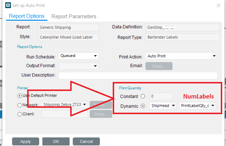

There is a NumLabels field on the Receipt Line. This can be filled in during Receiving.
Thanks, I didn’t spot that field.
FYI: You can also link the NumLables to the Quantity field in the BPM print. I like this better than configuring Bartender to make duplicates based on a field because if you do it at the BPM level you will get separate records for Bartender and no need to do “Magic” in Bartender.
