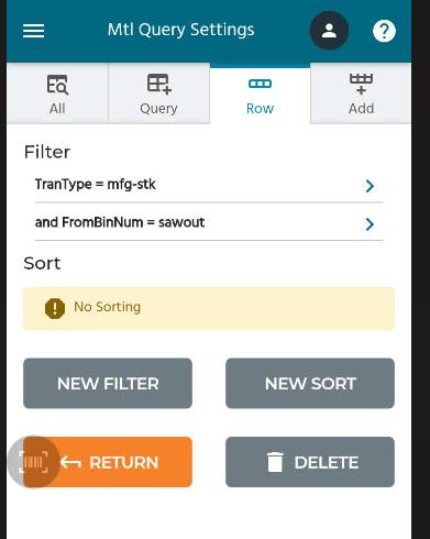

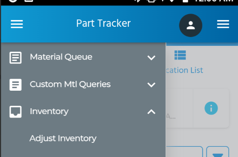

This is an out of the box feature. Depends on the end user’s access and what you all have setup for if it’s using handheld/mes security or not.
You should have an option called “custom mtl queries”
You can then set different sorting and filtering preferences, i.e. only stock to shipment transactions.
