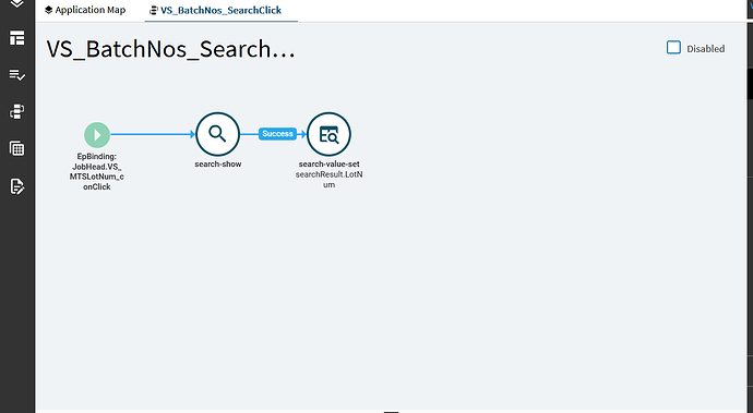

Hello @dcamlin,

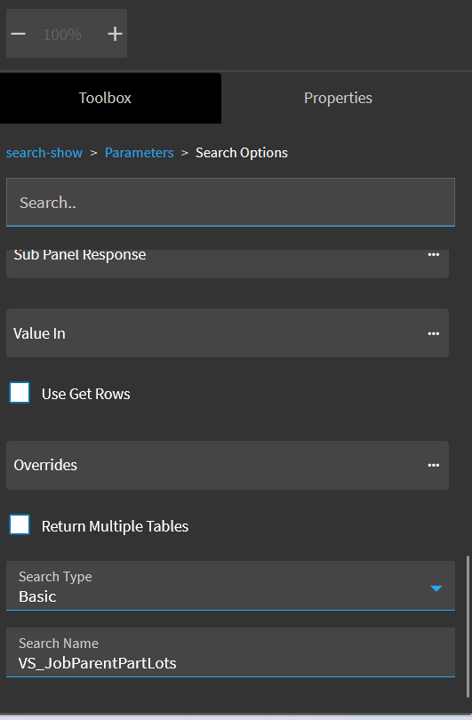

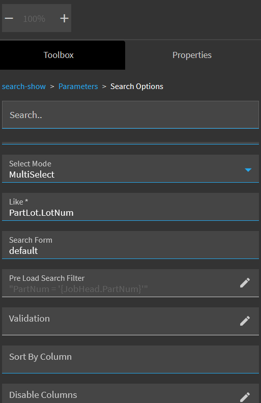

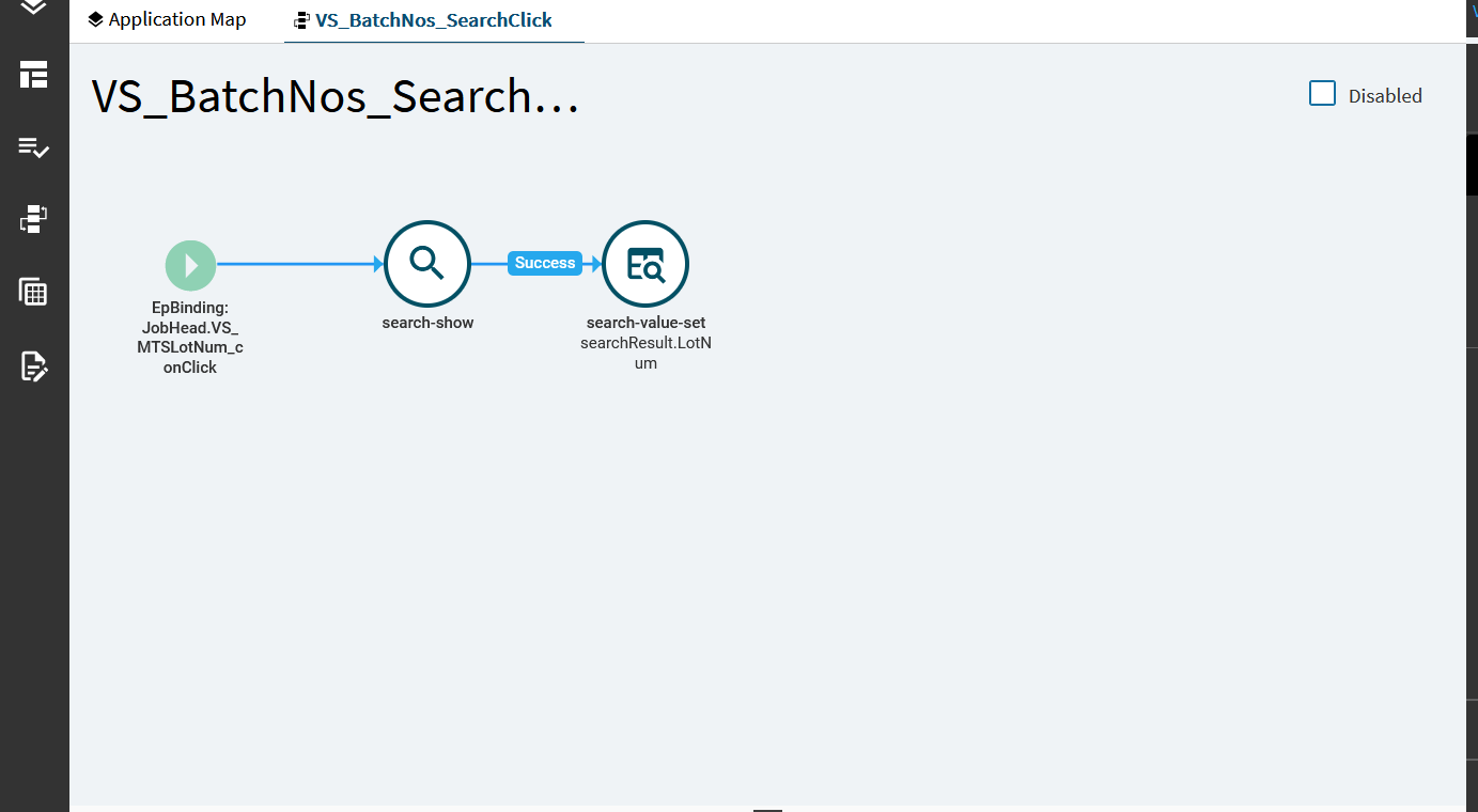

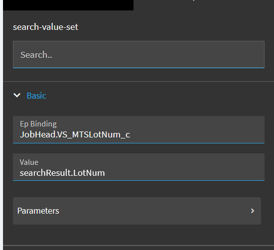

Thanks a ton for the suggestion. Honestly, Application Studio is so vast that sometimes we forget to check the simple, base functional widgets and end up taking the longer route :sweat_smile:. I had done the same — but finally managed to achieve it using the Show Search and Search Value Set widgets.
With this approach, the user can select multiple values from the BAQ search, and each value gets stored in a string format separated by a ~ delimiter. Super handy!
I’ve attached a few screenshots below of the event configuration for your reference.
In above Screenshot, In Search name field, my BAQ name is present to populate data in search grid.
