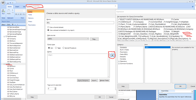

If you open up the report in SSRS Report Builder, try removing the isContiguous field from the columns in the query. We did that and it seemed to work fine again

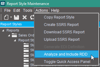

They do have that new tool for analyzing reports and fixing the rdd<->style matchup. Anyone had success with that?
Where is this tool located, what is it named, in Epicor to be able to run?
In Report Style Maintenance. It was suggested to me to run when I was having unrelated problems and it didn’t help. I’m not able to say that it won’t cause damage if used so maybe test on a copy of your main style first.
I tested it in Pilot and it said no issues were found but it still will not print

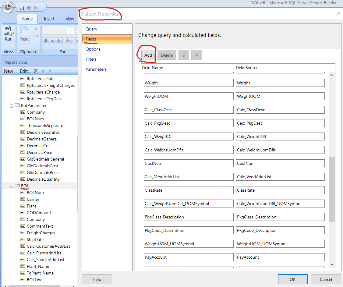

We upgraded to Kinetic and have the same issue that reports with a custom report data definition fail. I think the issue is that the report data definition and the report builder file no longer sync and have the fields matching up. I think we have to manually edit the report builder data set. I am trying to edit the dataset properties by going to the dataset in question, opening dataset properties, and then adding the custom fields to the expression.
After adding the fields to the expression, I then add the fields to the fields tab inside dataset properties.
You may also have to deal with the report labels in the same fashion.
Good luck. I still have not solved my own problem but think this is the direction that I need to take to get there.
