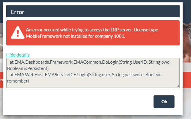

First time setting up EMA. I followed all the setup instructions in the new install guide and Configuring the mobile access (essentially checking the flag on the user to allow access), but I am getting this error. Any ideas on what this could be?
You need to enable the EMA license from the EAC. EMA is licensed on it’s own.
Correct me if I am wrong, but in the EAC license file this is the “MobileConnectAndroid”, “MobileConnectiOS” modules? I am not seeing any others that say anything about mobile
I actually dont have the licenses! Should have known thanks for the help
You need a license called Mobile Framework I think.
