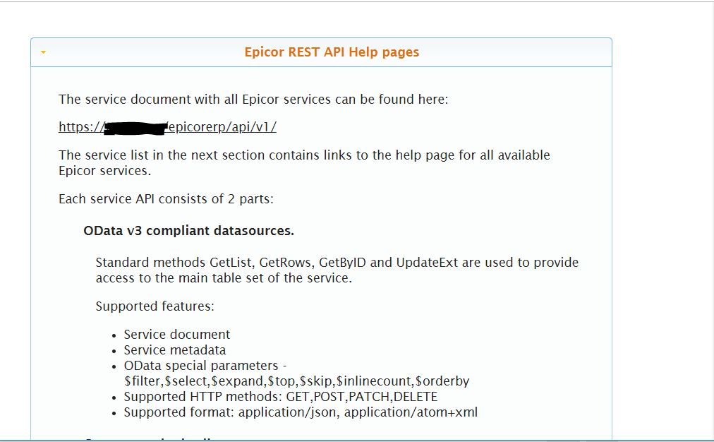

Can you call the rest services from your browser?
The format should be
Hi Andrew, yes I can call rest services from my browser.
Any ideas guys?
