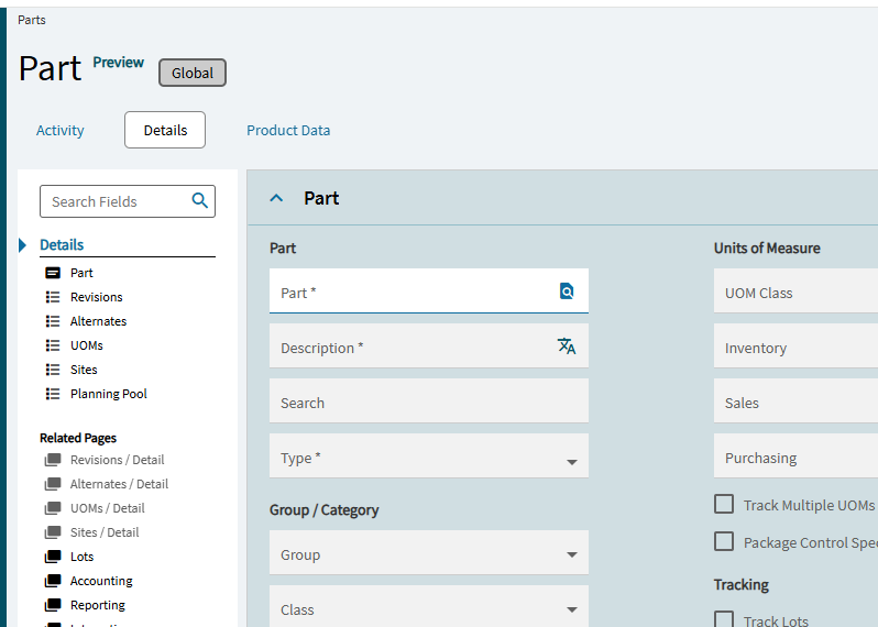

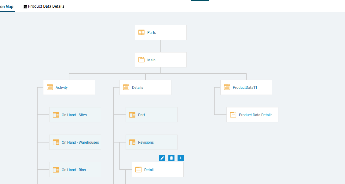

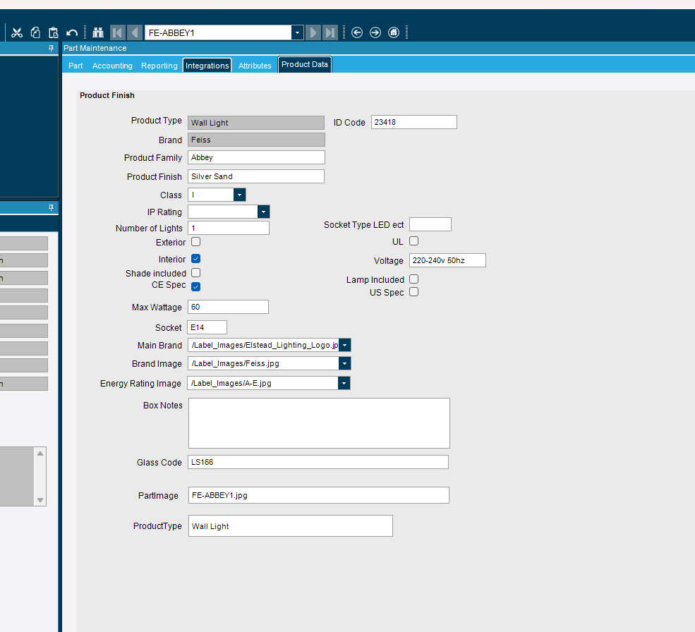

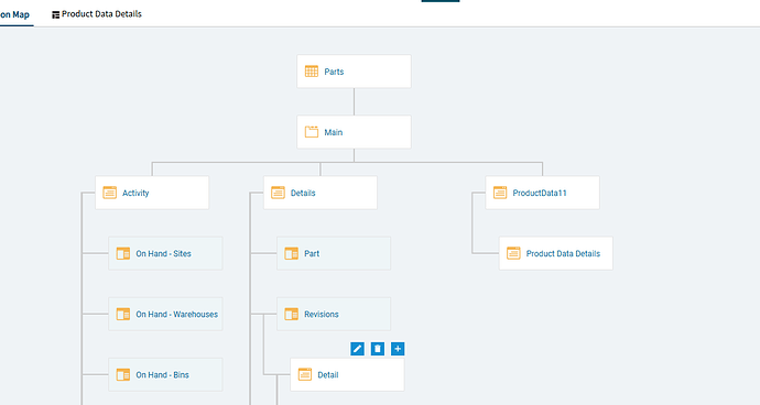

Hello, I have managed to create and deploy a new tab in part master this is to mirror how we had it in 10.2.700 in this tab is product information that gets pulled into bartender.

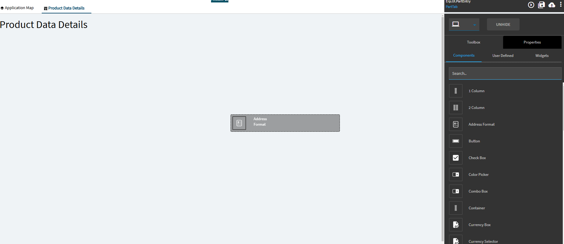

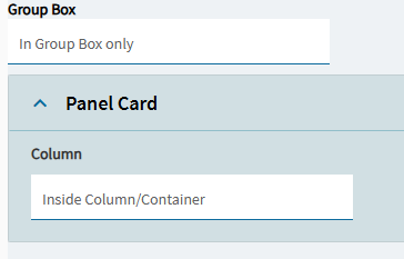

I have an issue now that I can drag a column into the new tab to pull in the UD fields its like it blocks me from adding anything from the toolbox into it

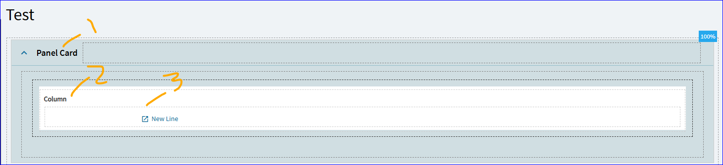

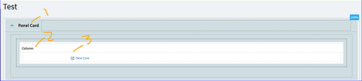

You need to add a Panel Card first (no. 1).
Then put a container… or column(s) into the Panel Card (no. 2).
THEN you should be able to add your Address Format control (no. 3) and others.
You can also throw in a Group Box, then your Address Format field … but the result just doesn’t look complete, in my opinion
