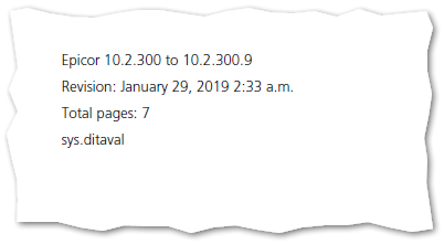

I was referring to the Change List - PDF section which is an accumulation of all the updated modules and the resolution types between minor revisions from the base version. I focus on the “All Changes” and “Software Interface Changes” between the version I have installed and the version I plan to install.
