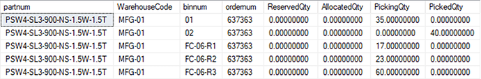

We are in the process of testing WMS processes prior to bringing into Live, however we have noticed an issue when updating Pick from location via Material Request Queue / EMWW app.
basically when we override the Bin locations assigned at allocation, and pick from an alternative location, we eventually get to the stage where picked quantities go back into picking…
  • Create a sales order for a part
  • Part should be in stock in multiple locations
  • Open fulfillment workbench and allocate & release for picking, search by Qty Ascending

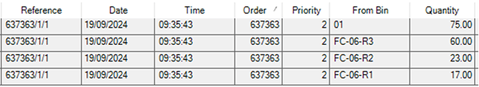

  • Material queue work is then created to pick quantity from specified locations
  • However, our operator may decide to / be instructed to override the allocations, and instead will take stock from Bin01 as there is sufficient stock there to fulfil the order

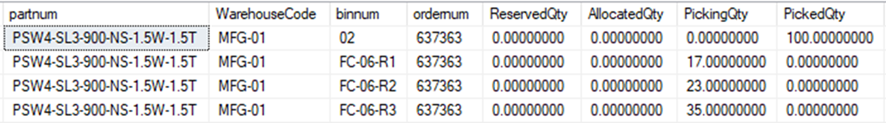

  • Operator overrides the location to Bin 01 for the line requiring 17pcs; Picked qty is updated, and database shows 17pcs in Bin02 (our Picked location)
  • They then repeat this action for the line requiring 23pcs, so Picked qty now correctly equals 40pcs
  • Next, they process the 60pcs and update to pick from Bin01, and again we see the Picked qty correctly updating

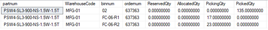

  • Finally, we go to the last outstanding record to pick the 75pcs. This time, the Picked qty does not update correctly:
  • As you can see, 40pcs have reverted to “Picking” status and the total Picked qty is 135pcs rather than 175pcs

This is a single order release, for 175 pieces?
You used the fulfillment workbench to allocate quantity in 4 separate BINs for this release, and created 4 different STK-SHP transactions in the Material Request Queue?
Where is the data in your screenshots coming from, a BAQ?
hi Garret
correct 175 pieces allocated over 4 location
this is just a sql query looking at the Partbin table for that specific sales order
mal
i should add
we can replicate this each and every time we follow this scenario
