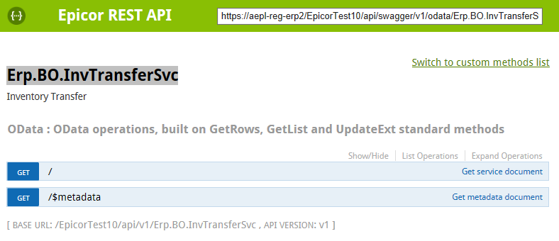

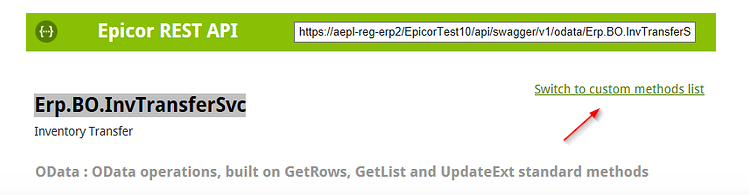

Has anyone tried doing an Inventory Transfer with the REST API? I scanned the list in the Swagger UI and saw:
Erp.BO.InvTransferSvc and didn’t think much of it. Fast forward to today and their are no ways to actually do this. I am on 10.1.600.13.
You’ll need to use the Custom Methods. InvTransferSvc is not a CRUD type BO so the REST generator is probably not smart enough to figure out what to do. Use the Custom Method

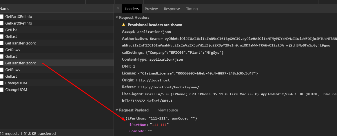

GetTransferRecord with the part you wish.

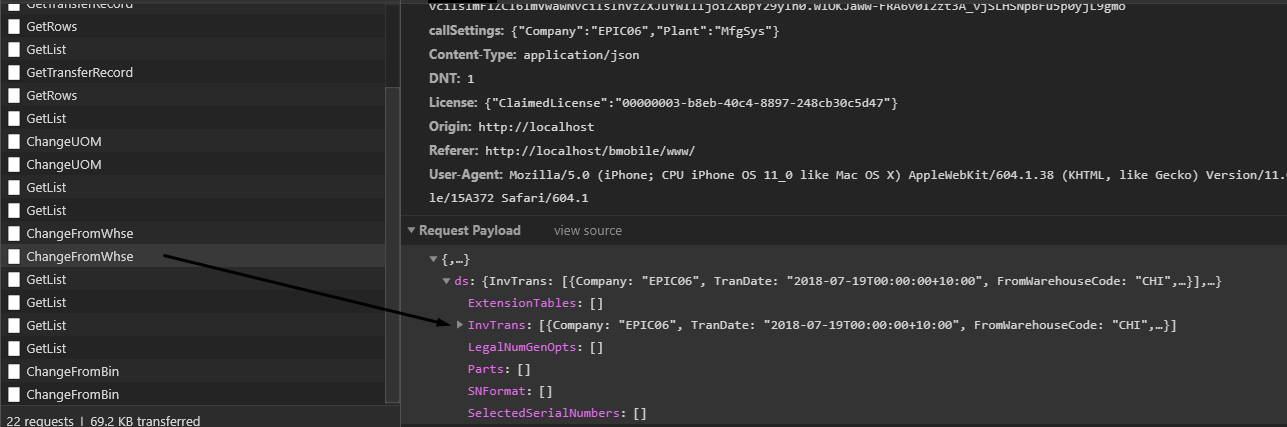

For each change of From/To Whse / Bin call the relevent Change Custom method with the dataset going through… (don’t forget RowMod U)

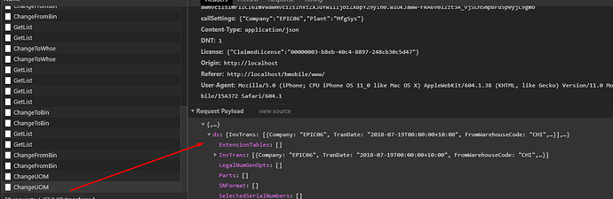

For change of UOM similar deal as above call relevant ChangeUOM method and send dataset through (dont forget RowMod U)

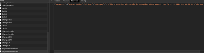

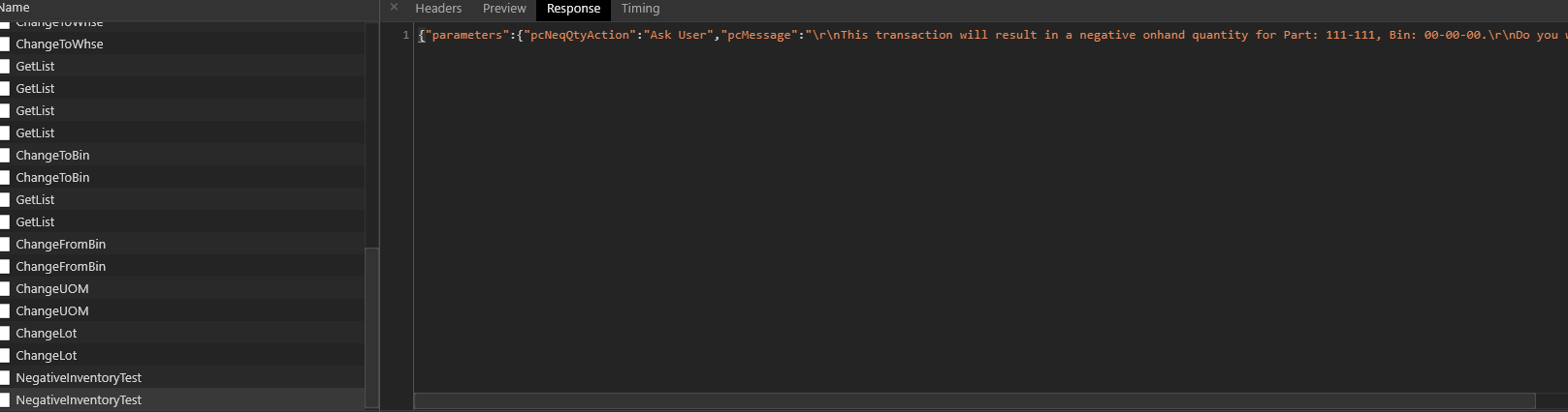

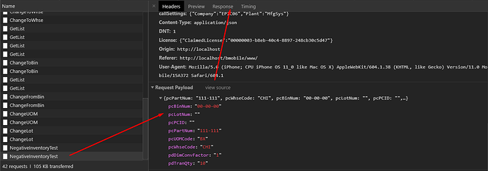

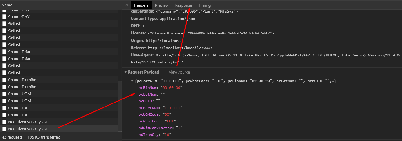

NegativeBinTest will take the following and if the result of the transfer is going to be a negative it will respond with a warning message. If it will not result in a negative inventory it will just be empty.
Negative warning
No warning.

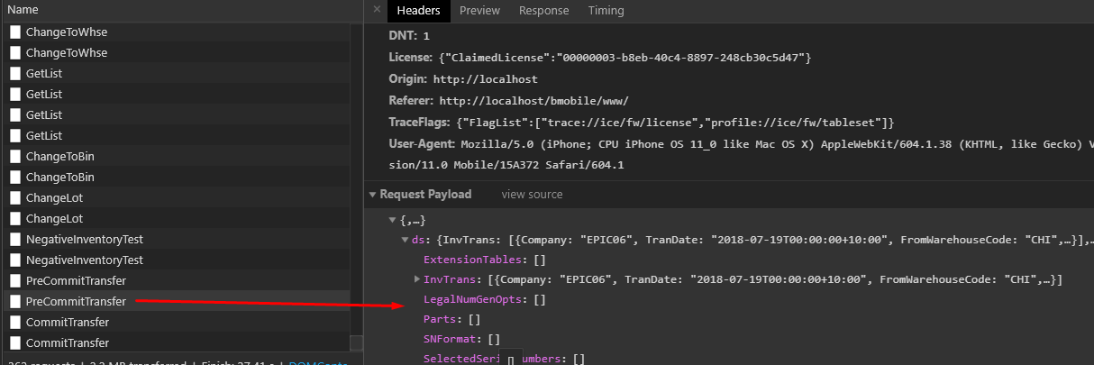

PreCommitTransfer is run however I dont believe that I ever figured out what that call does. Again RowMod U

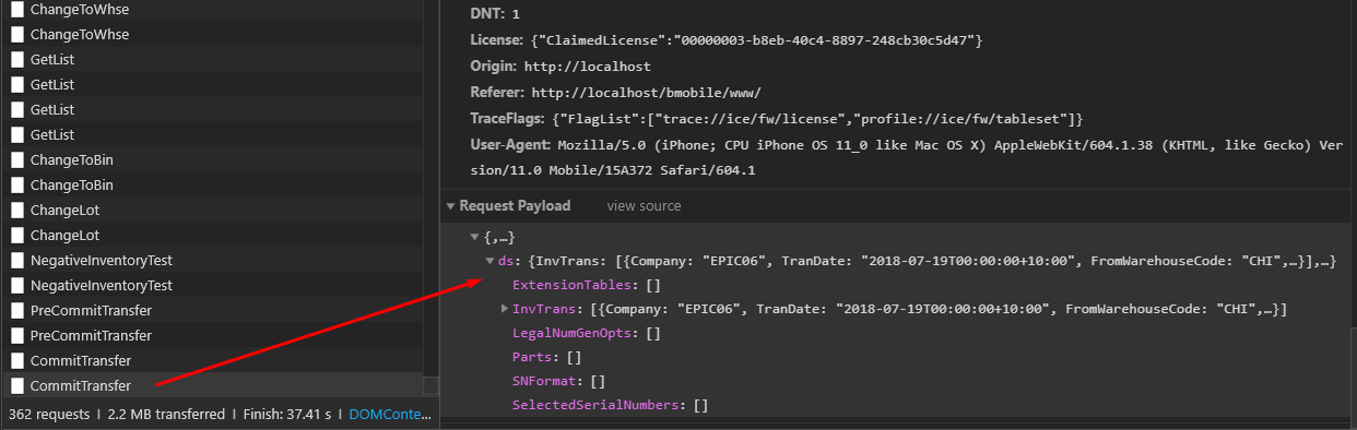

CommitTransfer is the last method that will execute the move in the backend. Again RowMod U
