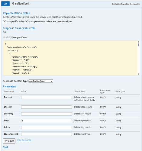

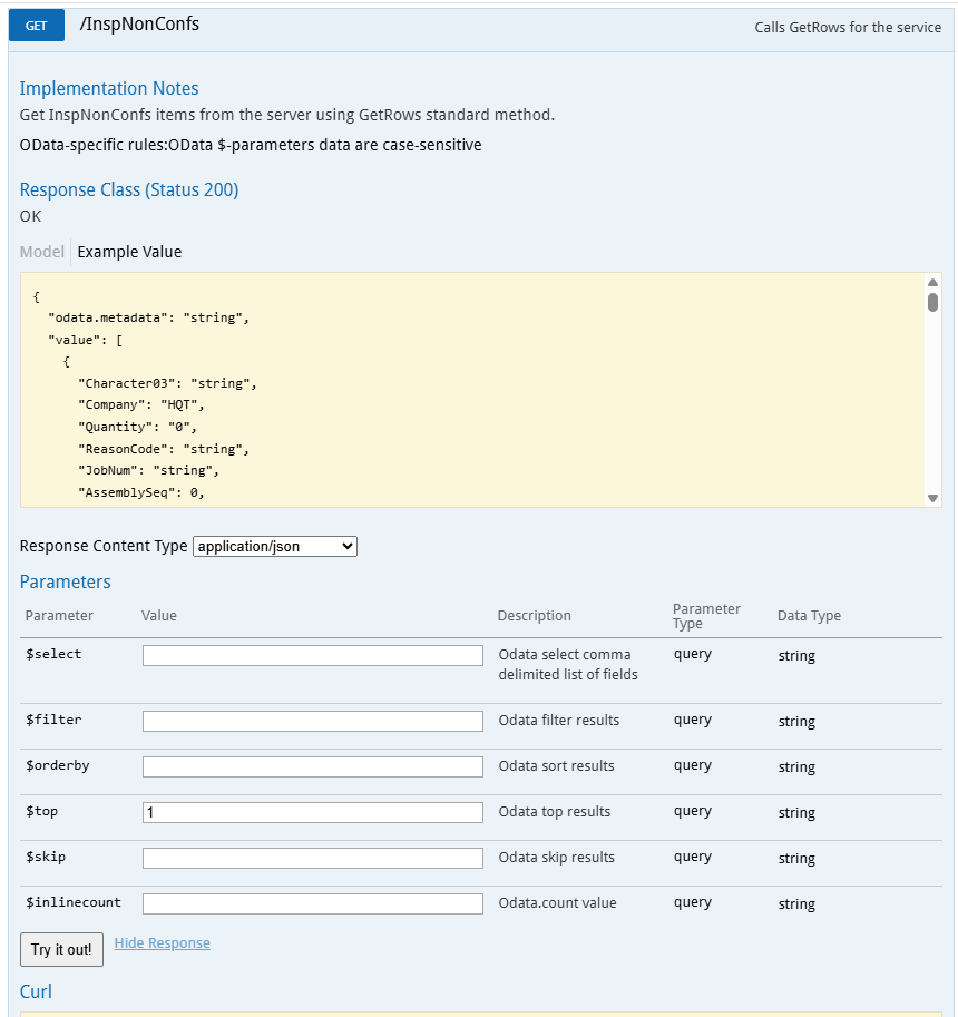

Hi everyone, I was trying to work with my Rest APIs specifically Erp.BO.InspProcessingSvc.
I tried to send a GET request as below and just got back an error. Did I do anything wrong?
I really appreciate all the help I can get~
