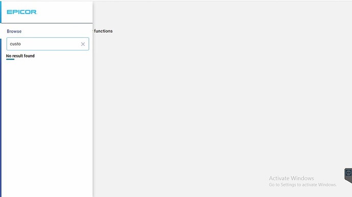

The Swagger test page is not working either.
See below for the production swagger. It says “No result found” when I search for any endpoint.

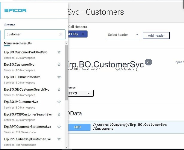

While below here is the test Swagger page, working fine.
