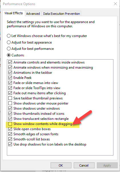

The lag only occurs when moving windows around the screen, when the window is stationary no noticeable performance problems occur. It only occurs when Show Window Contents While Dragging is enabled.
We’ve found disabling the Windows setting of Show Window Contents while dragging eliminates the problem. Just wondering if anyone else has had similar experiences. I’m guessing it’s something with infragistics not liking the new windows update? Anyone else experience this before?

This is the work around. I actually like this on my system better. Turn this setting off.
You can get to that on Win10 by searching for Advanced System Settings.

The work-around is to disable show contents while dragging from inside Windows.
