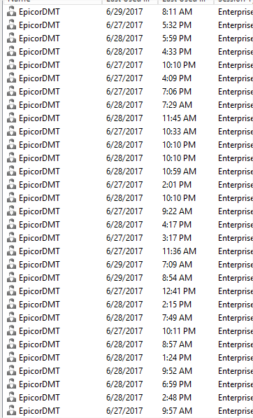

I’ve been utilizing the DMT / PowerShell Rick Bird demo’d at InSights this year. it’s working great!
However, it does leave a lingering Epicor session for each DMT use in the Admin Console. Not the worst thing in the world, but I’d like to clean it up. Anyone know PowerShell script for ending the DMT session?
This is the script I’m using to call DMT:
Start-Process -Wait -FilePath $DMTPath -ArgumentList "-User $User -Pass $Pass -Update -Import "TE Labor Combined" -Source $Source "
Any help is appreciated,
Ben

I am running DMT version 4.0.21.0 for 10.0.700 and after the PowerShell runs the Epicor Sessions still show as available in the Epicor Administration Console. is it possible we have the PowerShell syntax wrong?
I have just retested this on 10.0.700.4 as the session management is different in 10.1 but the session was added to Epicor Admin Console while the PowerShell script was running and the session was removed from Epicor Admin Console once the script finished. My PowerShell script is almost identical to Ben’s example.
@estm8ben @Arthur
My PowerShell syntax is almost identical to Ben’s example as well but I am also running BAQ Exports before each load and I still had all these sessions hanging out in the Epicor Admin Console.
Last week I noticed and upgraded my DMT client for our 10.0.700.4 environment to 4.0.23.0 and I noticed the"BAQExport - fixed “Unable to cast…” issue and now releases session correctly" entry in the following change log for 4.0.23.0:

This morning when I checked the Epicor Admin Console sessions I did not see any ‘available’ sessions for our EpicorDMT user from the various weekend scheduled DMT PowerShell tasks. apparently what was causing my issue the the BAQExport in my PowerShell and that is why the sessions were not closing out.
Not sure who got this fixed but thanks a lot!
-Rick
www.getaligned.solutions
I just need to update DMT?
Looks that way to me.
Before I did that I deleted all my epicorDMT user sessions that had a status of ‘Available’ as they would never close.
And then I gave it a few days - the weekend and checked the Admin Console and it looked like the sessions were being handled properly for BAQ Export mode.
-Rick
