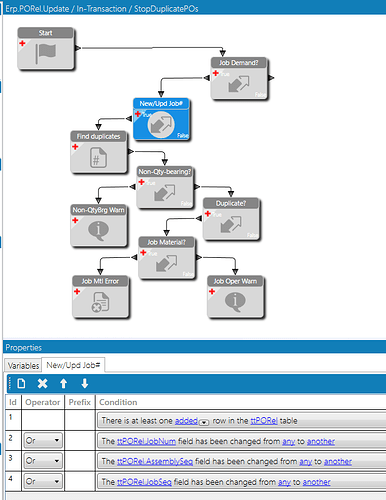

I made a data directive BPM to stop many of the duplicate orders, including the arrived bug.
It warns on duplicate operation orders and non-qty-bearing parts, but doesn’t prevent. I don’t like it but thats how we intentionally order quite a few things…
My code. Has Db reads, no writes. Feedback appreciated.
var ttPORelrow = ttPORel.FirstOrDefault();
gThisPONum = ttPORelrow.PONum;
//#### Get demand ####
if (ttPORelrow.JobSeqType == "M") {
  var JobMtlResult = (from t1 in Db.JobMtl
    from t2 in Db.Part.Where(t2r => t2r.PartNum == t1.PartNum).DefaultIfEmpty()
    where t1.JobNum.Equals(ttPORelrow.JobNum)
    && t1.AssemblySeq == ttPORelrow.AssemblySeq
    && t1.MtlSeq == ttPORelrow.JobSeq
    select new{t1.RequiredQty, t2.QtyBearing}).FirstOrDefault();
  if (JobMtlResult != null) {
    if (JobMtlResult.QtyBearing == true) {
      gDemandQty = JobMtlResult.RequiredQty;
    } else {
      gDemandQty = -1; //not qty bearing, don't check
else if (ttPORelrow.JobSeqType == "S") {
  var JobOprRelQty = (from t1 in Db.JobOper
    && t1.OprSeq == ttPORelrow.JobSeq
    select t1.RunQty).FirstOrDefault();
  if (JobOprRelQty != null) {
    gDemandQty = JobOprRelQty;
//#### Get Already Ordered Qty ####
var TotalOtherPORelQtys = (from t1 in Db.PORel
  && t1.JobSeq == ttPORelrow.JobSeq
  && t1.JobSeqType == ttPORelrow.JobSeqType
  && t1.VoidRelease == false
  && (t1.PONum != ttPORelrow.PONum //only other POs
  || (t1.PONum == ttPORelrow.PONum && t1.POLine != ttPORelrow.POLine)) //or this PO but other lines
  select t1.RelQty);
if (TotalOtherPORelQtys.Count() > 0) {  //Will be null if no more rows
  gOtherPOorderQty = TotalOtherPORelQtys.Sum();
  //get other PO info.. lazy code, nearly same query as above.
  var OtherPOInfo = (from t1 in Db.PORel
    select new{t1.PONum, t1.POLine}).FirstOrDefault();
  gOtherPONum = OtherPOInfo.PONum;
  gOtherPOLine = OtherPOInfo.POLine;
