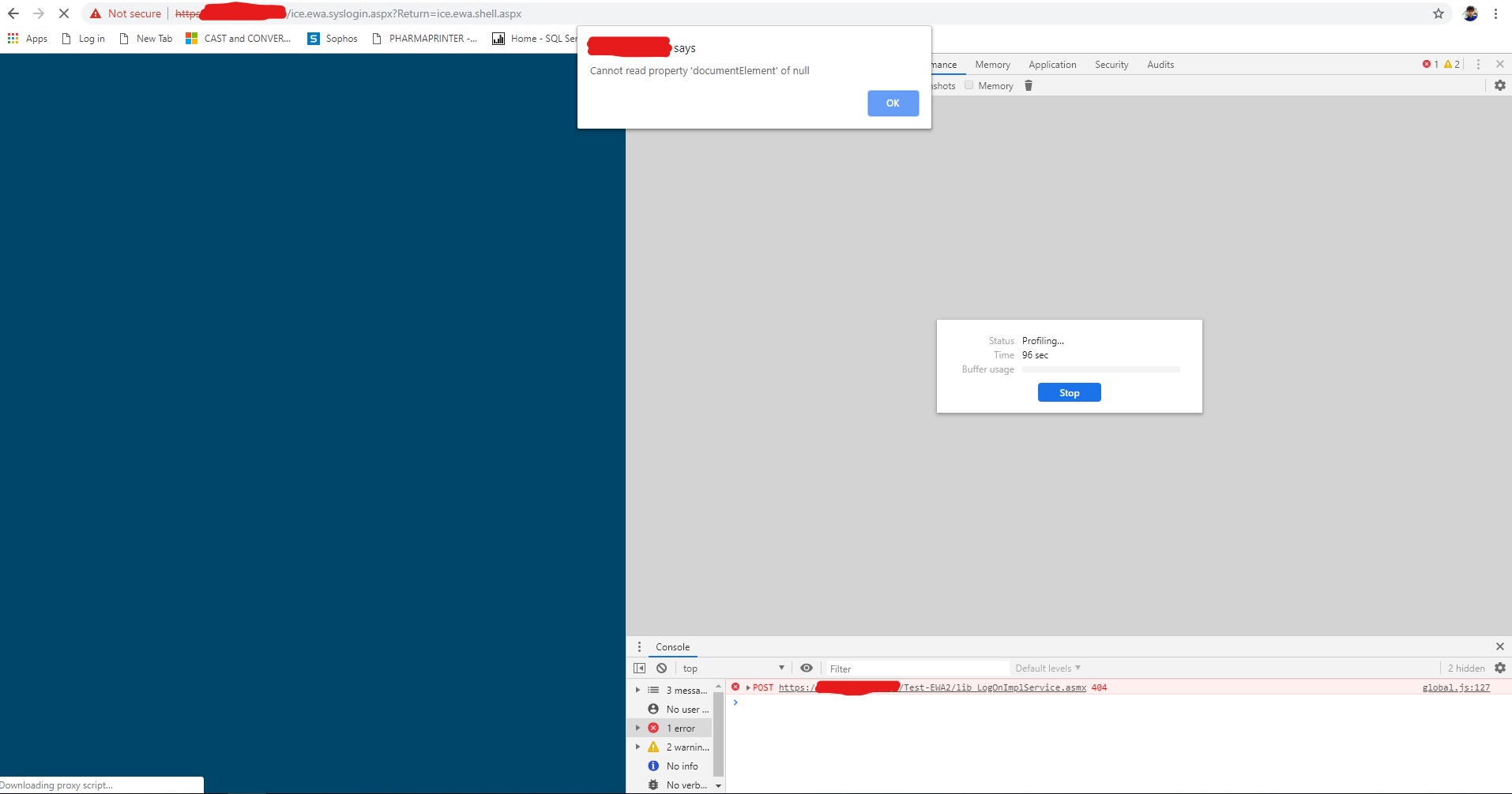

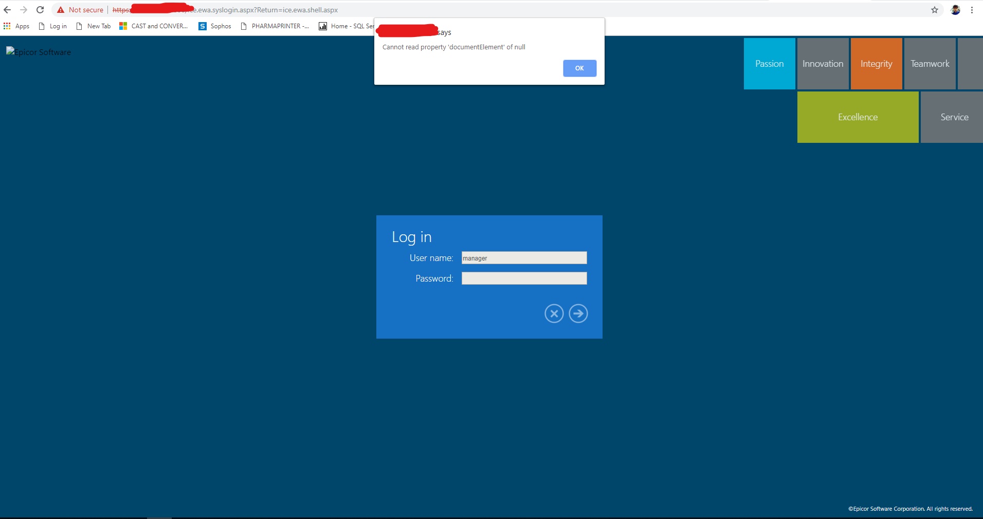

Did someone encounter this error while accessing epicor web? We are using here sophos firewall and I don’t think the error is coming from the firewall because we can access the port from the outside network. Can someone knows this kind of error.

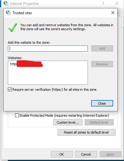

For the error message, check if by adding your URL to the Internet Options > Trusted Sites, it goes away.

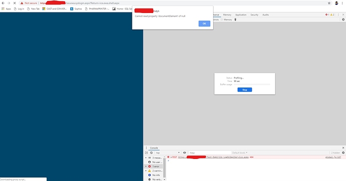

Press F12 which will open up Chrome Dev Tools then refresh, see what the Console returns for error.

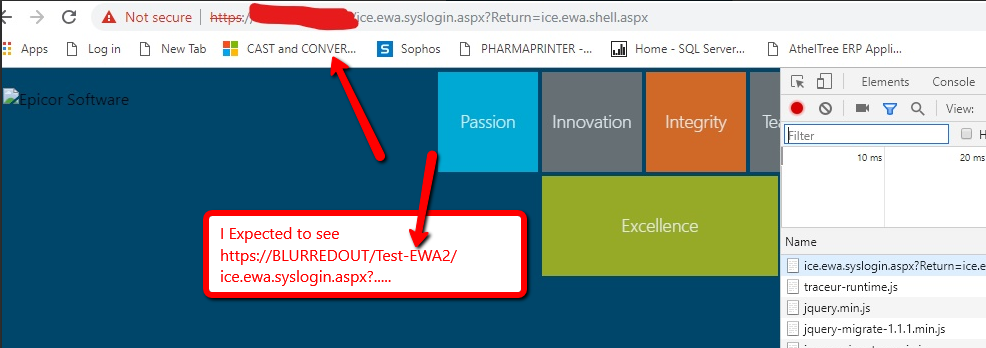

So its looking for a file in subdir /Test-EWA2/ – try chasing that down, why it would be looking for a sub-directory while you are on a / root pathi n the URL Bar.
I assume it should be trying to load
https://yoururl/lib_LogOnImplService.asmx
Thats all I can leave you with from what I can see in the screenshot.

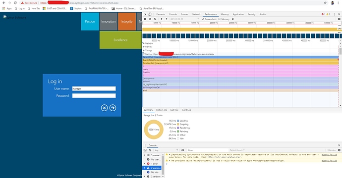

If you press Stop Profiling, does the console give more error(s)?
You could give us a Screenshot of this Tab.
