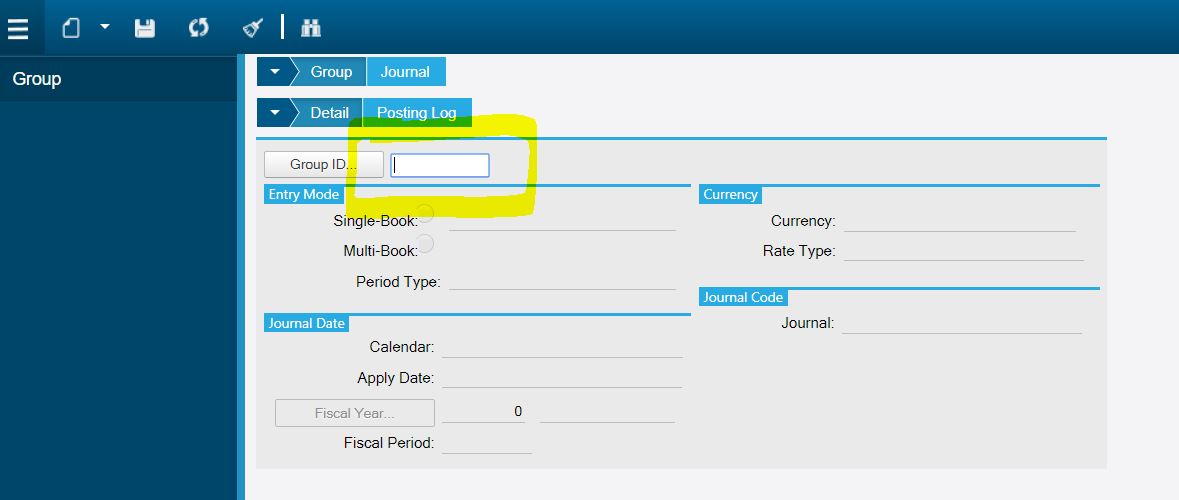

Dear experts, In Journal Entry form GroupID is autogenerated & set as ReadOnly. After generating web form, ReadOnly property is not working in EWA.
Could you please suggest how to resolve this issue?

I have used below mentioned code
// Custom code for GLJournalEntryForm
// Created: 6/6/2018 10:59:36 AM
using System;
using System.ComponentModel;
using System.Data;
using System.Diagnostics;
using System.Windows.Forms;
using Erp.Adapters;
using Erp.UI;
using Ice.Lib;
using Ice.Adapters;
using Ice.Lib.Customization;
using Ice.Lib.ExtendedProps;
using Ice.Lib.Framework;
using Ice.Lib.Searches;
using Ice.UI.FormFunctions;
public class Script
SetExtendedProperties();
private void SetExtendedProperties()
EpiDataView edvGroup = ((EpiDataView)(this.oTrans.EpiDataViews["Group"]));
if (edvGroup.dataView.Table.Columns.Contains("GroupID"))
edvGroup.dataView.Table.Columns["GroupID"].ExtendedProperties["ReadOnly"] = true;
