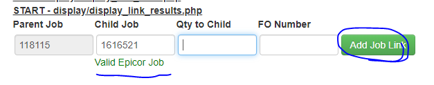

In Firefox, Chrome, and IE (I had to set Intranet sites to NOT run in protected view), when I fire an .on(“change”) event to the Child Job field, it runs an AJAX call to the REST API and verifies that the job exists in Epicor. If it exists, JQuery displays the “Valid Epicor Job” message and shows the “Add Job Link” button:
