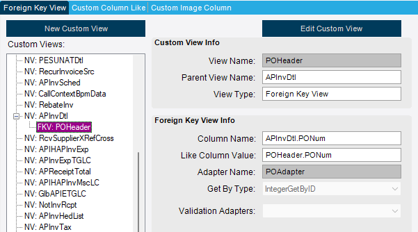

On the AP Invoice Entry menu I have created an FKV for POHeader.

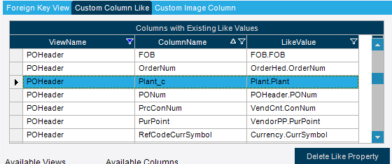

I have never used an FKV before, so I hope I did it correctly…The columns do show up under Custom Columns, including the field I am looking for, which is Plant_c.

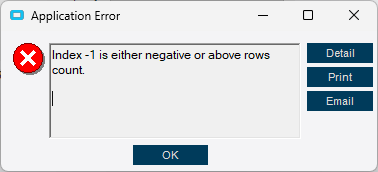

That event fires, and the first message box appears with the PO Num, then an error appears:
I am assuming that the edvPOHeader DataView has not been populated at this point.

I have tried that, but since it appears the FKV isn’t populated with any data, it errors out with the “Index -1 is either negative or above rows count” message.
