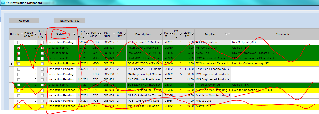

We have an updatable dashboard that users would like to have cells highlighted based on the data in the field.
We have rowrules set up today. The issue with the rowrule is that it highlights all columns which makes it difficult for the users to see which columns they can update.
If I go the route to loop through the grid to set the color of the cell manually, which event should I use? Or is there an EpiMagic feature that I am overlooking. Based on my quick search I don’t see an EpiMagic feature.
Mock up of what users are looking for Users only want the status column to be highlighted. See how the comments field loses its “updateable” color.

Set the row rule to the desired field instead of All Fields.

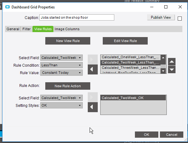

Banderson
(Brandon Anderson)
November 8, 2018, 10:35pm
5
You can do all of this in the dashboard settings as well, so you don’t have do it in code.

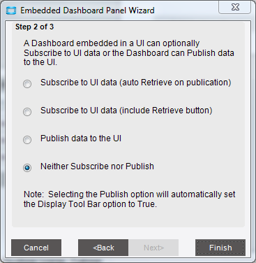

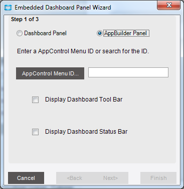

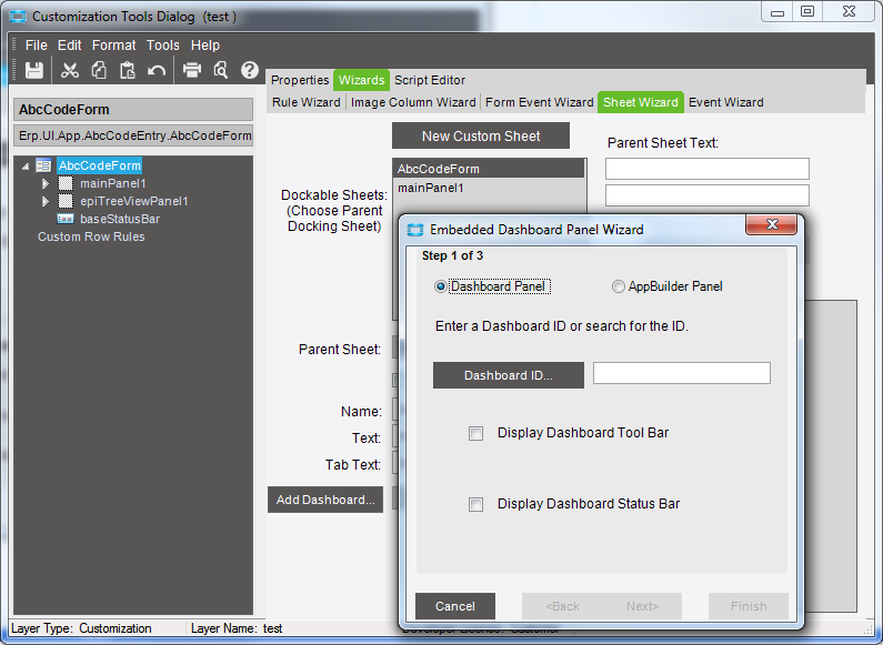

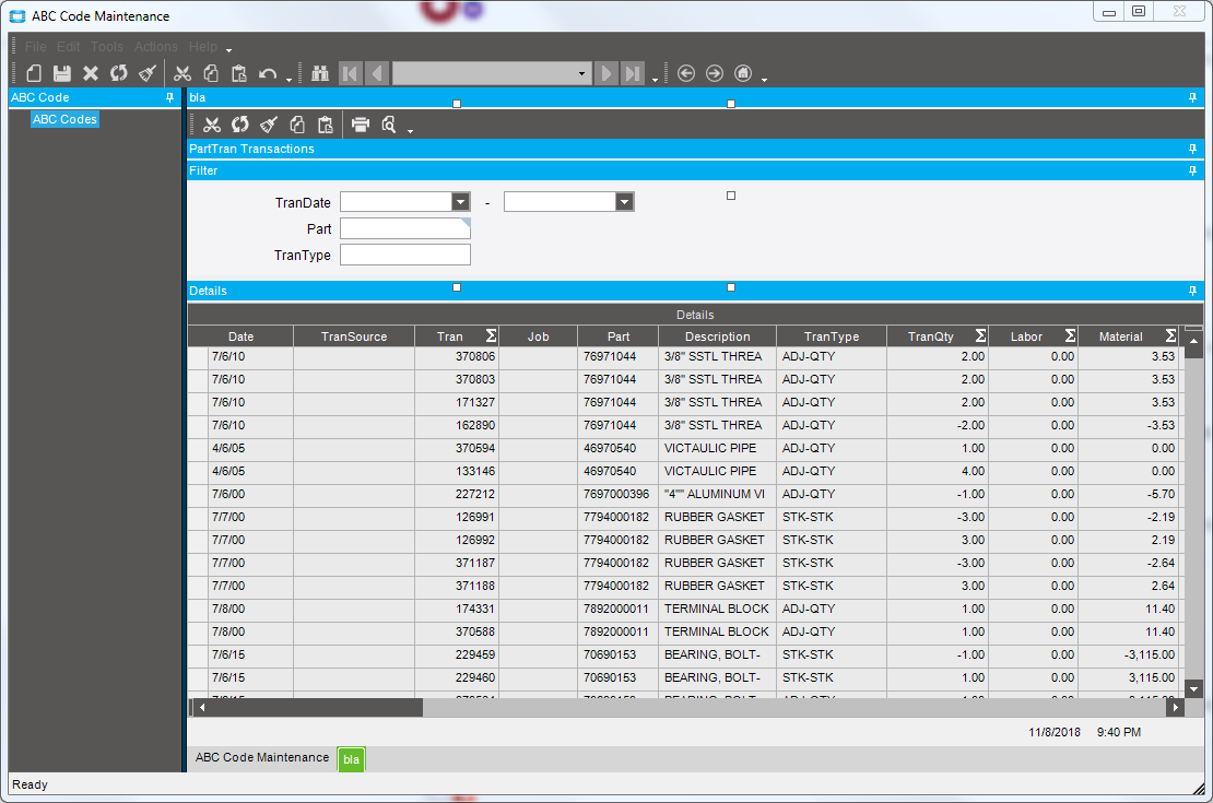

What Brandon was thinking, there is another possible option and the assumption is that you become modular then and you can re-purpose the grid’s. That is to build a Dashboard and then Embed that Dashboard to the UI. According to Epicor it supports both Runtime and Assembly:
Then you could take it out of the Panel and Dock it somewhere else if needed.
It certainly can be magical. I just haven’t found a way to Embed it with a Menu ID that HAS a Customization as a Layer.

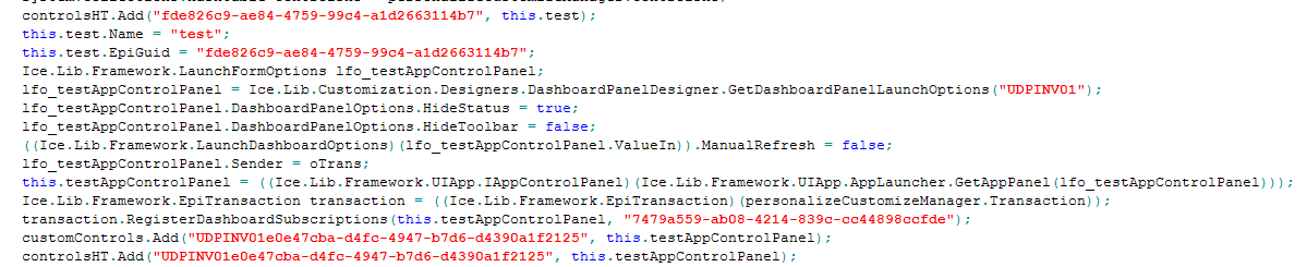

You can also inspect the Show All Code, and add it manually via code:
You can also hit Customize on the Toolbar or Add a Key to show the Main Menu bar as well File, Actions etc…

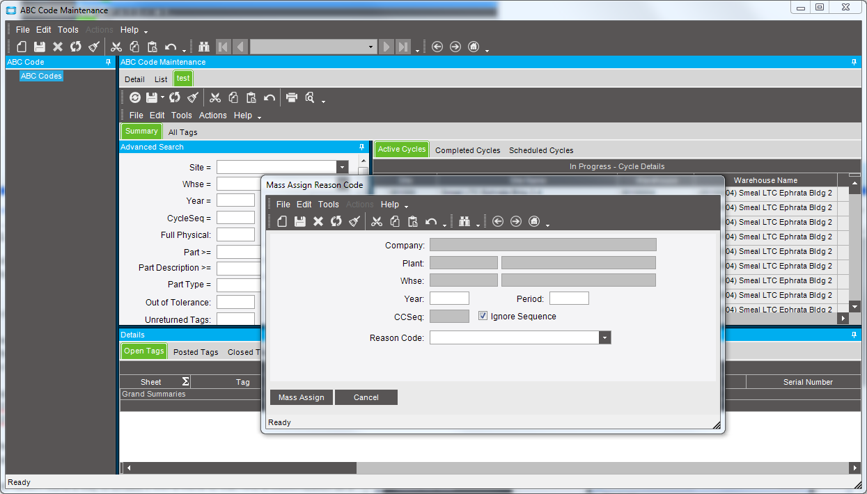

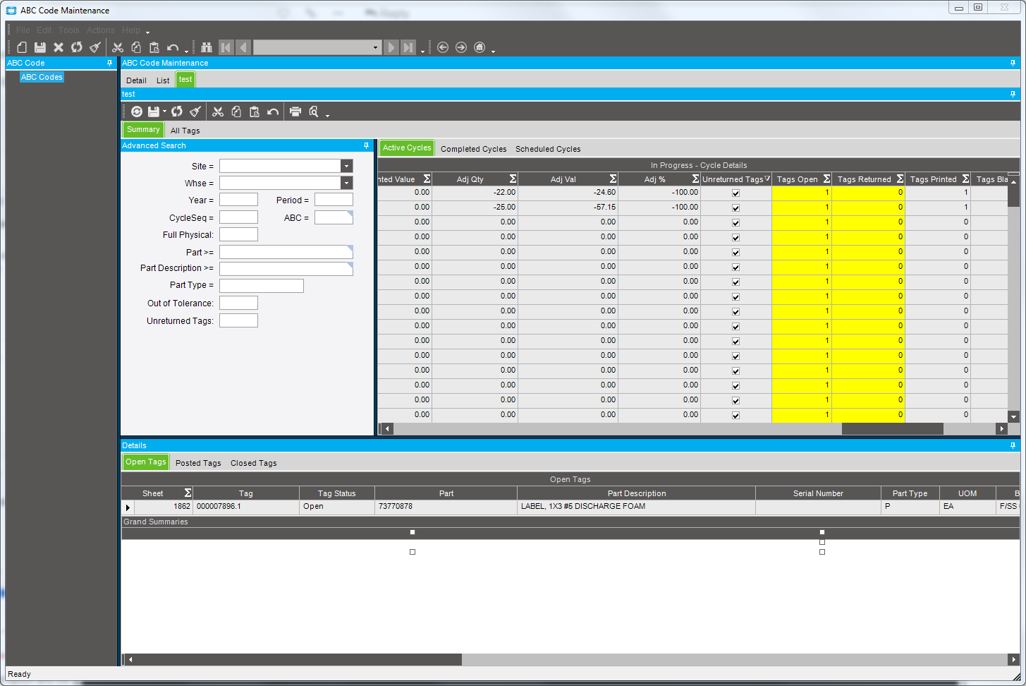

Here I have an Updatable Dashboard that also has a Custom Action to Bring up a BPMForm, embedded into ABCCode for an Example:
EDIT: But it didnt Publish data to the BPMData Columns, sadly
Perhaps there are limitations, I don’t know them all; but certainly a possibility for simple grids.
But it sure as hell doesn’t clutter up my Customization.
