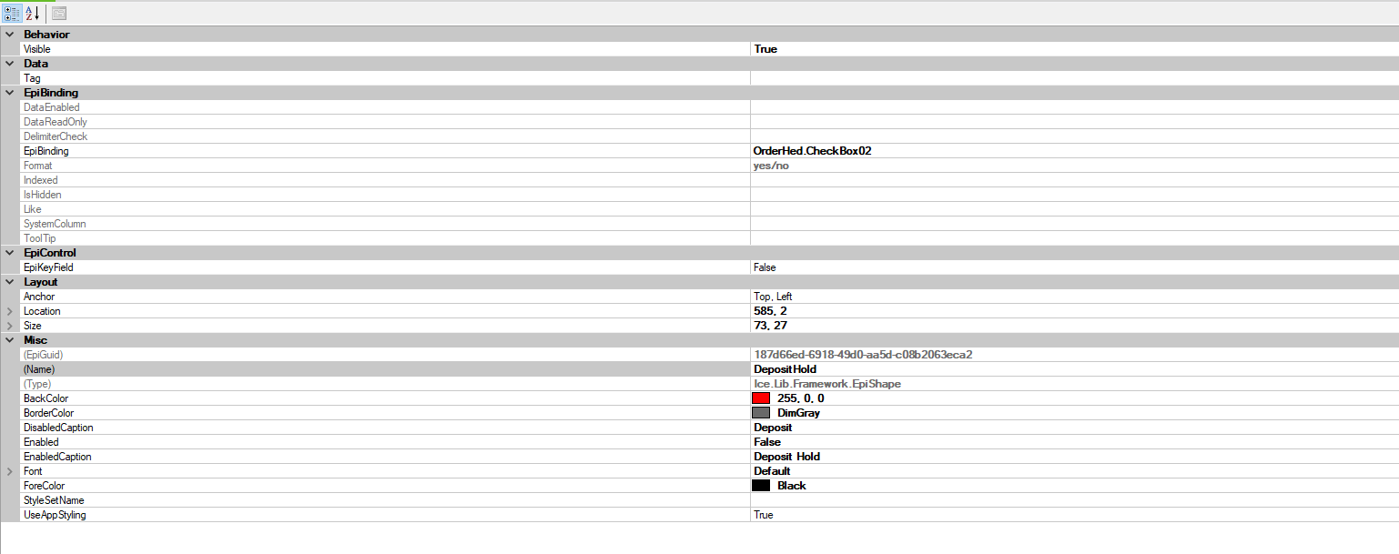

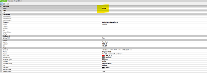

This will not stay set to false…Ideas?? According to the checkbox, this should be hidden now…AND, when I open back the customization, it shows the false was reset to true. Oh, and I have it set to red, but shows up green…what am I missing???
Yeah visible doesn’t always work becuase epicor is using code to make it visible again. Tried and true way to make something go away… location -500,-500
Will it reappear when it’s true at that location?
it will but outside of any viewable area
Well, I’m wanting it to be like the credit hold epishape. How do I make that work?
I think just like buttons you can EpiBind it to OrderHed.DepositHoldShape
and then you can use Row Rules, you have to explicitly type that binding out and pretend it exists.
