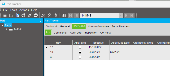

EpiUltraGrid filter/select/active row issues
Hello,
I’ve been trying to use Infragistics.Win.UltraWinGrid, Infragistics.Win, Infragistics.Shared to filter my EpiUltraGrid and hopefully select the top displayed grid row as active and also select it. I’ve tried to use Grid Filters and save the layout, but an active row is still present that’s outside of my filter. Here I’ll attach my code. I understand a lot of it is overlapped, but I can’t seem to form a connection with my EpiUltraGrid even with it’s GUID. Here I’ll attach the “All Code” as a PDF :
partTrackerCode.pdf (2.1 MB)

The grid may not exist at that state in InitializeCustomCode
Try moving down to Form.Load, failing that Form.Shown.
You’ll probably have to wire Form.Shown manually, as it’s not in the wizard list.
Does this look better? I don’t know how to run any tests. Should I do any Trace logging or BPM’s?

Thank you for your patience. I did recieve a message saying “local5 is not an instance of EpiUltraGrid” This is for a Part Tracker form so I’d assume a Part Num needs selected first
Revision is still selected
as seen here
If local5 IsNot Nothing AndAlso TypeOf local5 Is Ice.Lib.Framework.EpiUltraGrid Then
’ local5 is an instance of EpiUltraGrid
MessageBox.Show(“local5 is an instance of EpiUltraGrid”)
            local5.DisplayLayout.Override.ActiveRowAppearance.BackColor = Color.IndianRed
            local5.DisplayLayout.Override.SelectedAppearancesEnabled = DefaultableBoolean.False
            local5.Selected.Rows.Clear() ' Deselect all rows
                local5.ActiveRow = Nothing ' Deactivate any active row
                local5.ActiveCell = Nothing ' Deactivate any active cell
                local5.Update() ' Update the grid to reflect the changes
        Else
            ' local5 is not an instance of EpiUltraGrid
            MessageBox.Show("local5 is not an instance of EpiUltraGrid")
        End If
