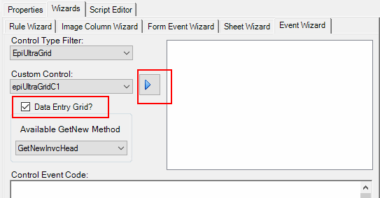

There is a checkbox on the Event Wizard you need to use
This will generate several events and will prompt you to select the GetNew()… function to call
Thank you for this. I have been struggling for awhile.
