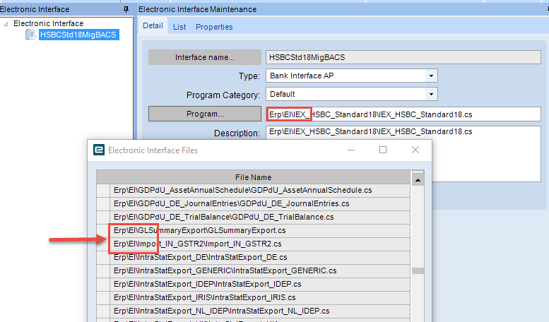

The .cs does ot seem to be there at all (see screen shot) ?!
Look on the server look in the Web Site Directory and then Server\Erp\EI you should see folders setup by CSF install. On my server I think the one you are looking for is called Payment_UK_HSBCStandard18 and not the name you have in the screen. Try linking to this one.
Found the location you mention, changed the program and now get an output file. Not quite in the correct format - but it looks like we are over the hurdle!
