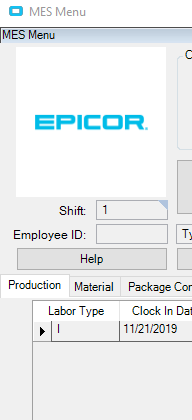

Just noticed that our Employee ID field on the mes screen is not populating. Could this be why nothing is being passed on? It compiles correctly it launches the report correctly. However, it does not pass anything over to the report.
