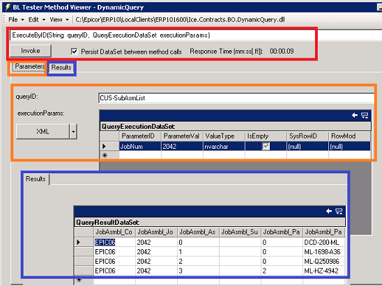

For now, ref BL Tester screenshot below
Simple example of specifying a BAQ, its parameters and the QueryResultDataset.
