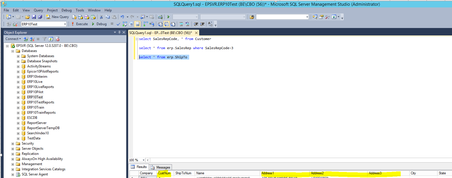

The data you want to update isnāt stored in the Order tables. Neither OrderHed nor OrderRel, its via the relationship the ShipTo table via ShipToCustNum and ShipToNum where the address fields live in the database.
