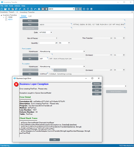

Erp.Services.BO.InvTransfer.dll - "Error creating PartTran. Please retry."
Does anyone have an idea of where why I would constantly get a “Error creating PartTran. Please retry.” error message with the following code below? I’ve looked through a couple other similar posts, but can’t seems to get anything different. This external code called via BPM.
I’m attempting to add a new inventory transfer, but it always fails at CommitTransfer. I feel like I have everything that’s need (based on other posts here), but no luck so far.
Here’s part of the stack trace…
Description: Error creating PartTran.  Please retry.
Program: Erp.Services.BO.InvTransfer.dll
Method: doPartTran
Line Number: 1591
Column Number: 33
Table: PartTran
Server Trace Stack:    at Erp.Services.BO.InvTransferSvc.doPartTran(String ipPartIUM, Boolean ipPartTrackDimension, String ipPCID, String& partTranPK) in C:\_Releases\ERP\UD10.2.400.18\Source\Server\Services\BO\InvTransfer\InvTransfer.cs:line 1591   at Erp.Services.BO.InvTransferSvc.ProcessInventoryTransfer(InvTransferTableset& ds, String& legalNumberMessage, Boolean refreshttInvTrans, String& partTranPKs) in C:\_Releases\ERP\UD10.2.400.18\Source\Server\Services\BO\InvTransfer\InvTransfer.cs:line 1230   at Erp.Services.BO.InvTransferSvc.CommitTransfer(InvTransferTableset& ds, String& LegalNumberMessage, String& partTranPKs) in C:\_Releases\ERP\UD10.2.400.18\Source\Server\Services\BO\InvTransfer\InvTransfer.cs:line 829   at Erp.Services.BO.InvTransferSvcFacade.CommitTransfer(InvTransferTableset& ds, String& LegalNumberMessage, String& partTranPKs) in C:\_Releases\ERP\UD10.2.400.18\Source\Server\Services\BO\InvTransfer\InvTransferSvcFacade.cs:line 312
Any ideas?

Anyone ever figure this out? I’ve run into this lately, in 3 places - REST (EFx), DMT, and even in the client:
I am forcing the deferred update in the Efx; perhaps this is messing things up?
Yeah, it worked fine after a couple minutes - client and DMT - with the same parts, bins, quantities, etc.
Ugh, this does not bode well for my app, though.

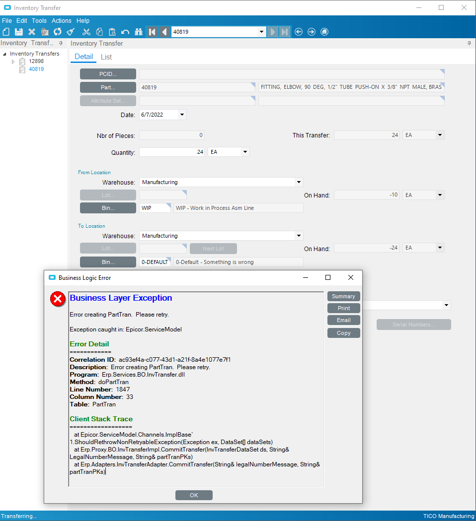

I’ve got to come up with a good way to reproduce the problems on demand. But here is what I’ve seen.
There are about 3 scenarios in play:
  1. System as is (using only the client for transactions)
    a. No issues
  2. Issue Transfer material via REST/Function
    a. Initial problem: cannot transact same part twice rapidly
    b. Initial solution: Invoke the deferred update. All seems to be well
  3. Implementing both (1) and (2) with many users
    a. Intermittent failures with the “PartTran” error (like the title of this post)
    b. Sometimes the issue happens in the client and sometimes it’s an error in the REST call.
I have to think that it’s this hybrid approach (3) that gets me in trouble. One hand is deferring an update and the other hand is forcing it through immediately.
One thing I do wonder about: I’ve been putting this code at the end of my Function. Should it be at the beginning? Or both beginning and end?
OK, I see what is happening.
Today we got the error with no prior inventory transfers today for the part. There were prior transactions, but not bin to bin. This was the aha moment.
A few things.
First, it looks like the culprit is an EFx that I made for reporting quantity to an operation (via Labor BO). We backflush parts and I did not have deferred update on this EFx - for one big reason: I made it before I made the inventory transfer one and didn’t know I needed it.
So I added deferred update to it and I seem to be avoiding the error. (Won’t be sure till I put it in Production.)
Second, I was saying the problem was hitting the same part repeatedly. Sort of true. It’s the same part and bin. If I use the same part and do not use the same bin (in or out), then there were no issues. But regardless, I think the first point should resolve this.
And third, adding deferred update to the beginning of an EFx does not help.
Three working days now since I made the change and no errors through about 700 runs. Looking good.
So, the point here, is that if you ever make any function/BPM/uBAQ/etc. and it deals with part movement or issue or any transaction, I think you need to invoke the deferred update in that function.
This seems to be true even if the transaction is indirect like an operation that backflushes material.
