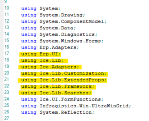

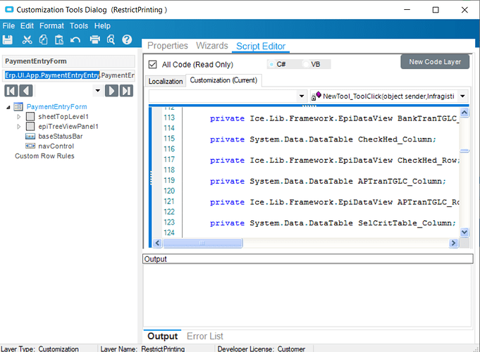

I was wondering if there is any documentation available for the higher level namespaces in Epicor like Erp.UI.App.
What methods and properties are available for use in custom code? Does Epicor provide us with that level of information? I know we have the object explorer available from within the customization, but that doesn’t expose anything above the adapter level unless I’m missing something.
