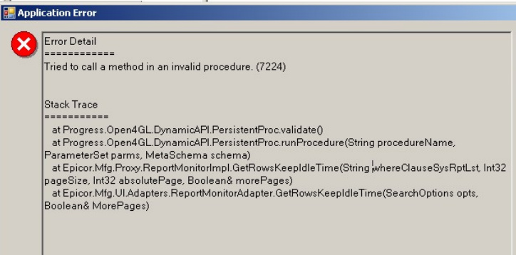

This just started yesterday but when we login to Epicor we have no problems, we close the program and get a 7175 and then a 7224 error, then epicor seems to shut it’s self down and when I look in progress explorer tool, the mfgsys database has stopped. If I re-start the database I am able to login to epicor again with no problems, but as soon as I try to exit out of epicor, I get the errors again and the db shuts down again. This occurs on the appserver itself and also client machines. I have went thru and disabled all BPMs active in Live and still get the errors. I have tried restarting the OE service and also all of the appservers several times. Server restart also did not fix the issue. All of the drives on the server have plenty of free space.

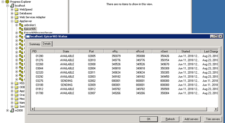

Appservers show they are still running in explorer tool after the errors and the program crashes. Once I re-start the database only, I can log back into Epicor. I never touch the appservers.

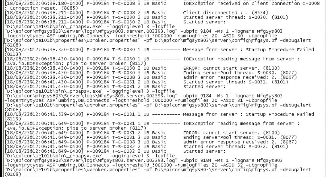

Here is the broker log from the main mfgsys appserver
IO Exception received on client connection…Are you sure you don’t have some other device on your network with the same IP, or a flakey secondary DNS server, or a faulty cable.
