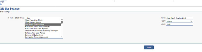

There is a limitation number in the site settings. I believe it defaults to 100. You can change it to 1000.
Ah, I knew there was something that could be done there; however, we had already changed that to 10,000 as a limit previously and the error persists. I am planning to have the customer adjust the threshold for that specific customer to hopefully reduce the Auto-Match results.
