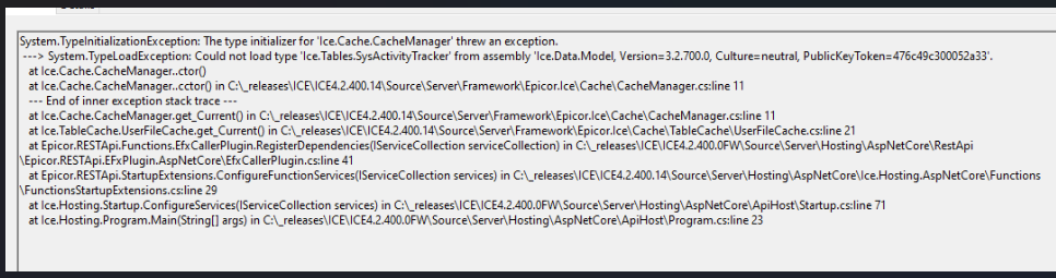

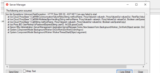

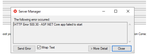

I am trying to setup new Kinetic environment but getting below error when trying to connect to the application server.
I have already tried rebuilding .net framework packages and restarting with no luck
Your Ice.Data.Model version is old - from 3.2.700 and it cannot be used from the new version 4.2.200.
