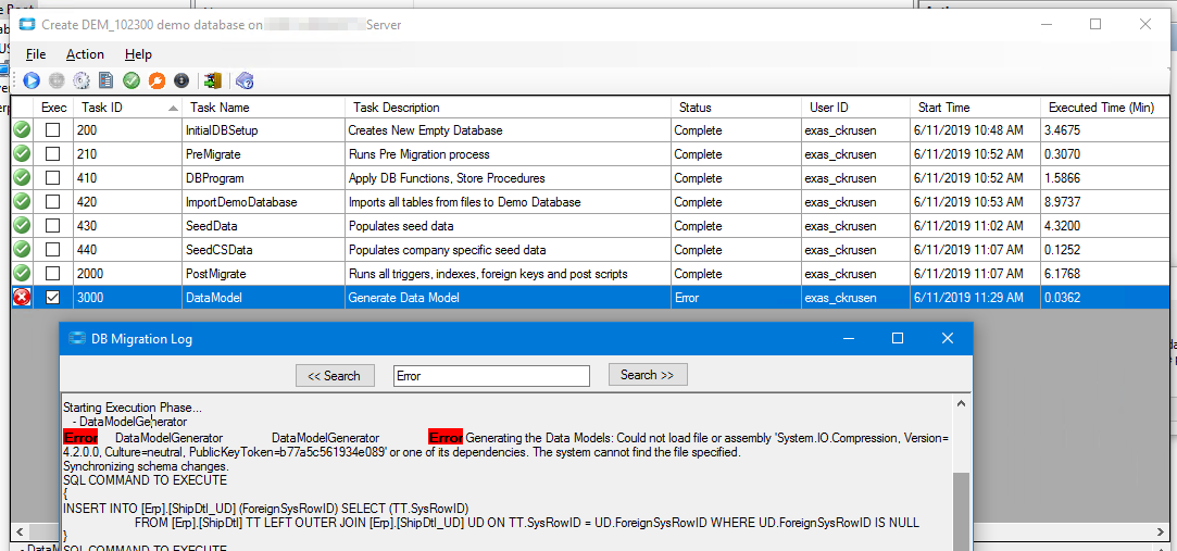

Error during creation of data base New Install of 10.2.300, DemoDB
Doing a new install of 10.2.300, and when trying to create the Demo DB, I get the following:
(and the text of the error, should someone search for that:
Error Generating the Data Models: Could not load file or assembly 'System.IO.Compression, Version=4.2.0.0, Culture=neutral, PublicKeyToken=b77a5c561934e089' or one of its dependencies. The system cannot find the file specified.
I tried clicking the Start button again to see if it would execute task 3000. But get the same exact thing.

As for the other error - what’s the OS of the server? I’m thinking you might not have the .Net 4.7.x version loaded up that is a pre-req for 10.2.x versions…
A-HA!!! Not sure how I missed that.

I think if you look in the sections above that for the appserver roles, you’ll also see .NET specified there… Looking at the 10.2.300 New Install Guide, I’m seeing it on pages 19 or 21 depending on OS, plus page 22 for SSRS. Now, this guide calls out 4.5.x and 4.6.x, so I have misquoted above, but I think I solved the same issue with Data Model regen by installing the 4.7.x version…
Calvin - did the .Net install fix the Data Regen problem? I see you marked it as a solution, but your follow-up comments/questions make me wonder… :slight_smile: If not, you should also check the other posts here for solutions as there are quite a few with regards to errors during Data Model Regen.
Installing .NET 4.7.2 solved the problem. I just got a little defensive about having missed that requirement.
