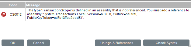

Hey Rob,
How were you able to find the relevant part of your code that belonged within the transaction scope? I am having a hard time figuring this out. I tried just wrapping the whole thing and it told me to add a reference to assembly System.Transactions.Local (I am unable to find it to add to the assemblies).
Adding my error message in case it helps:

You’ll need to have the .Net 6 SDK installed.
If you do that, and are getting missing dependencies like above, check this thread:
You probably have an empty folder there it’s referencing.
no, the error is different. SDK should be enough Does .NET 6 SDK need to be installed on all users workstations?
I installed the latest SDK and that did solve the problem I was having in my initial reply. Thank you! Now when I try and run my BPM I am getting the same error I was before I implemented @klincecum’s recommended fix here:
