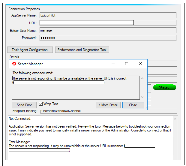

Hi
When I try to connect Application server it gives an error. Database connectivity is okay. I also checked the IIS settings and it seems good. Attached screen shot for your reference. Anyone can help?
Sazzad
Hi
Sazzad
Well ya covered the URL which is what the error is about…
Look in the Event Log what does it say
Have you verified IIS is running on the server as well. I see the started green button in the background, but without the URL we are not sure how to direct you. I would make sure you can ping or resolve the server name in the URL. Assuming you are running the admin console on the server this should be easy. Like @josecgomez stated we need some more details.
@Jeowings Yes I can ping and resolve the server name on the URL. I checked the IIS settings and it is running. I forgot to mention it happened after I update the Epicor from 10.2.200.27 to 10.2.200.32
Is the Epicor Admin Console on the same server or are you trying to run it from a client machine?
@jeowings it is on the same server.
It has been fixed. I had to remove the application server and add new application server.
@josecgomez After removing and adding the application server it was fixed. But after restarting the Epicor server again it is unable to connect to the application server with the same error message. Any idea any it is happening and how can we fix it?
