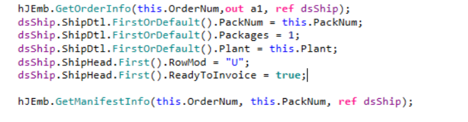

I am trying to create a “function” that does the shipping, but when creating a line and calling the “GetManifestInfo” method, I get the following error: “Record not available.”
I took out the trace and these are the methods I call when creating the line.
- GetNewOrdrShipDtl
- GetOrderInfo
- GetManifestInfo (At this point it breaks)
- BuildShipToList
- CheckPrePartInfo
- GetOrderLineInfo
- GetOrderRelInfo
- BuildShipToList
- CheckPCBinOutLocation
- UpdateMaster
See in “Trace” that RowMod “U” is set to ShipHead and ReadyToInvoice to “true” so i added it hoping it would work but it didn’t.
